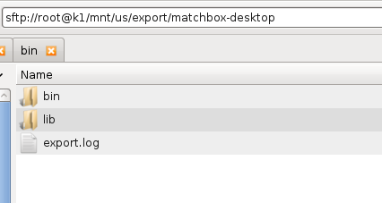

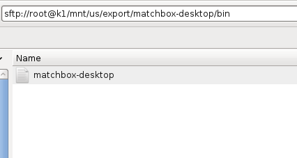

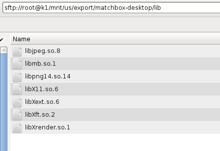

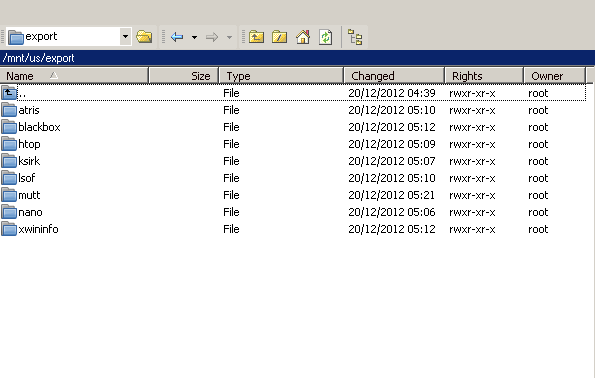

Old 12-20-2012, 05:45 AM   #5
twobob
( ͡° ͜ʖ ͡°){ʇlnɐɟ ƃǝs}Tır
twobob's Avatar
Posts: 6,586
Karma: 6299993
Join Date: Jun 2012
Confirmed as working on the 3...
okay... using the files from post two. (bash and find are the biggies)
no changes in the code.
on a 3
(let's give it a tough one)
[root@kindle root]# filechecker /mnt/us/usr/bin/matchbox-desktop
copying /mnt/us/usr/bin/matchbox-desktop to /mnt/us/export/matchbox-desktop/bin/matchbox-desktop
Searching 468 user libs, 58 libs, 16 extended dirs
libmb.so.1
non native result /mnt/us/usr/lib/libmb.so.1
libXft.so.2
non native result /mnt/us/usr/lib/libXft.so.2
libXrender.so.1
non native result /mnt/us/usr/lib/libXrender.so.1
libfontconfig.so.1
kindle supported at /usr/lib/libfontconfig.so.1.3.0
/usr/lib support detected
libfreetype.so.6
kindle supported at /usr/lib/libfreetype.so.6.3.20
libpng14.so.14
non native result /mnt/us/usr/lib/libpng14.so.14
libjpeg.so.8
non native result /mnt/us/usr/lib/libjpeg.so.8
libX11.so.6
non native result /mnt/us/usr/lib/libX11.so.6
libXext.so.6
non native result /mnt/us/usr/lib/libXext.so.6
libz.so.1
kindle supported at /usr/lib/libz.so.1
libc.so.6
kindle supported at /lib/libc.so.6
libdl.so.2
kindle supported at /lib/libdl.so.2
Export complete at /mnt/us/export/matchbox-desktop
ensure you run matchbox-desktop like: LD_LIBRARY_PATH=../lib ./matchbox-desktop
result so yeah. just update your old versions of things in a safe way.
over-ride, not overwrite
(although I overwrote my various find and egrep calls with the bins just to see if it would blow the device up and it seems fine) but really just invoke it by path or something.
but - at a pinch - you can just overwrite /bin/bash and /usr/bin/find
WARNING!! They are symbolic links that point to busybox
RENAME THEM TO name.old (like /bin/bash.old) before you attempt to replace them or you will overwrite your busybox...
: ) Nice

Old 12-20-2012, 08:07 AM   #7
twobob
twobob's Avatar
Posts: 6,586
Karma: 6299993
Join Date: Jun 2012
Lets do one more and see what might go wrong.
I will do debians file
(apt-get install file inside debian if you don't have it)
(mount the ext.3 if it isn't already)
[root@kindle bin]# mount -o loop=/dev/loop/debian,noatime -t ext3 /mnt/base-us/debian.ext3 /mnt/debian
okay good to go
[root@kindle bin]# filechecker /mnt/debian/usr/bin/file
copying /mnt/debian/usr/bin/file to /mnt/us/export/file/bin/file
Searching 937 user libs, 85 libs, 17 extended dirs
libmagic.so.1
non native result /mnt/us/usr/lib/arm-linux-gnueabi/libmagic.so.1
libz.so.1
kindle supported at /usr/lib/libz.so.1.2.3
libc.so.6
ld-linux.so.3
kindle supported at /lib/ld-linux.so.3
Export complete at /mnt/us/export/file ensure you run file like: cd /mnt/us/export/file/bin; LD_LIBRARY_PATH=../lib:$LD_LIBRARY_PATH ./file
let's test it
[root@kindle bin]# cd /mnt/us/export/file/bin; LD_LIBRARY_PATH=../lib:$LD_LIBRARY_PATH ./file ./file
/etc/magic, 0: Warning: using regular magic file `/usr/share/misc/magic'
file: could not find any magic files!
ro ro! it don't work!!!
let's just hack the resources on to the root (they are tiny)
[root@kindle bin]# mntroot rw
[root@kindle bin]# mkdir -p /usr/share/misc/magic/
[root@kindle bin]# cp /mnt/debian/usr/share/misc/magic.mgc /usr/share/misc/magic.mgc
[root@kindle bin]# mntroot ro
and test it again
./file: ELF 32-bit LSB executable, ARM, version 1 (SYSV), dynamically linked (uses shared libs), for GNU/Linux 2.6.26, BuildID[sha1]=0xb47ce3b5fc4138f5cc958deeeabeab1b1bb782a5, stripped
sweet. so yeah - that is the kind of thing that might go wrong.
not too tricky all in.
no doubt there will be cases where walking the required resource tree would be nice. parse a strace log maybe? : D
sed would have been a better solution for accessing the resources on the FAT drive.
patching the file binary to accept the new location
Anyways - hope this helps other forgetful developers.
HOW DO I MAKE INSTALL???
on my system (where my PATH includes /mnt/us/usr/bin and /mnt/us/usr/lib by default) to do a "make install" I would just
[root@kindle bin]# cp -r /mnt/us/export/file/* /mnt/us/usr/
where file is the name of the exported application. You could do something similar
