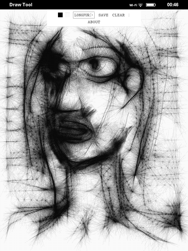

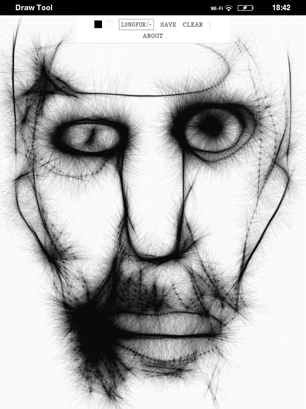

some screen tests
ID:	89683   Click image for larger version
ID:	89684   Click image for larger version
ID:	89685   Click image for larger version
ID:	89686   Click image for larger version

Old 07-24-2012, 01:06 AM   #12
TulseLuper
TulseLuper plays well with othersTulseLuper plays well with othersTulseLuper plays well with othersTulseLuper plays well with othersTulseLuper plays well with othersTulseLuper plays well with othersTulseLuper plays well with othersTulseLuper plays well with othersTulseLuper plays well with othersTulseLuper plays well with othersTulseLuper plays well with others
TulseLuper's Avatar
Posts: 61
Karma: 2667
Device: kindle touch
Some screens tests from draw tool
and yes ! as you can follow back on this thread we figured out a way to get those screenshots alive on KT!
ID:	89639   Click image for larger version
ID:	89640   Click image for larger version
ID:	89641   Click image for larger version
ID:	89642   Click image for larger version
TulseLuper is offline   Reply With Quote
