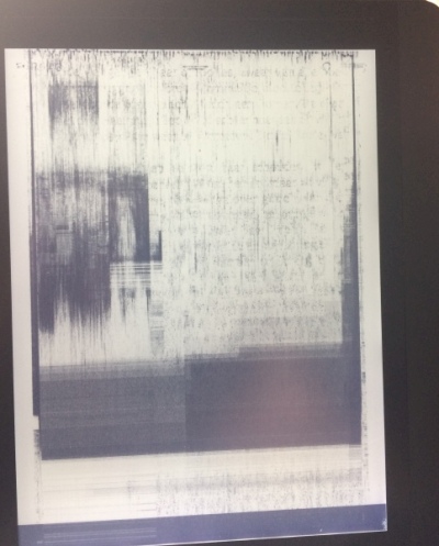

I have a pocketbook 840/Inkpad 1 for almost 2 years (so almost out of warranty).
Since a few weeks the screen sometimes is completely garbled or almost blank when I turn a page or when the device turns itself off (showing the book title page).
I can see the screen responds to the buttons and the screen. After a few or sometimes tens of 'page turns' the screen suddenly is OK again and ever as crisp as it should be. It also 'fixes itself' if I turn pages with the touch screen, hardly touching the screen. Pressing the screen or device body will not invoke a garbled screen (or fix it for that matter).
It can take days or minutes before the problem turns up again.

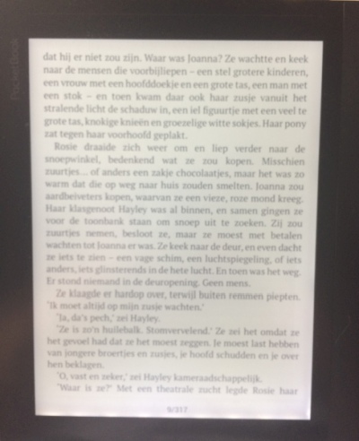

The first two images show the problem, the third is when the screen is suddenly OK again. I stayed OK until it turned itself off again.
I set full page refresh to every page, but that has no effect it seems.
Has anybody seen this problem before?

I haven't noticed anything like that on my Inkpad 1. How is the battery life on your device? I wonder if you have an issue with the battery not providing enough power for the screen. Do you see this problem while reading when the device is charging? Anyway, it is likely a hardware issue of some sort if you haven't updated the device recently. It might be a good idea to send it back before the warranty expires.

I must say I do not track the battery life. I can still use it intensively for several days, or leave it off for weeks without a problem. The battery was at 84% last time it happened. Plugging it into a charger does not fix the problem when it arises. Not sure that means it is not the battery.
I will contact pocketbook to see what they think.

Just an update. My problems became progressively worse until the screen just remained a garbled mess, just a few weeks before the Pocketbook warranty would expire..
I contacted Pocketbook who pointed me to their rma site. After sending in my inkpad 1 to fixxIT (free of charge) I received a new Inkpad 3 with again a 2 year warranty!
Now that is what I call service!!
