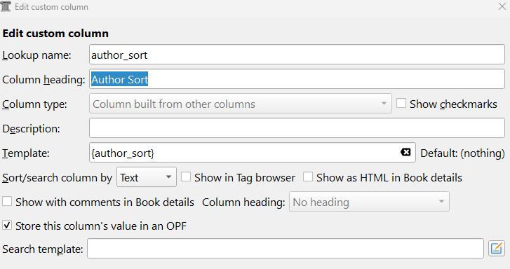

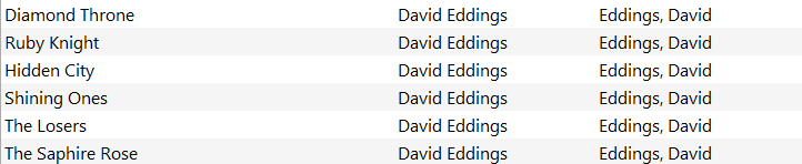

You could always hide the Author field and show an Author Sort field. I've done a screenshot of the column definition and calibre with both fields shown.
Name:	Screenshot 2025-03-02 115108.png
ID:	214029   Click image for larger version
Name:	Screenshot 2025-03-02 115218.png

Yes, that's a solution too. I've thought of it, but I prefer the separate library approach also for other reasons - I only have a relatively small subset of my whole library on my Kobos, and it's simpler for me to keep that subset (well, copy of the subset) in a separate library and connect my Kobos only to that specific library, not to the main one. Maybe I'm just too used to doing things this way.
Old 03-02-2025, 05:48 PM   #7
Posts: 48,295
Karma: 174315444
Possibly. But if it works for you, nothing wrong with not doing it the "standard" way.
I tend to be very conservative in what I do with my calibre libraries. I have two libraries (Intake and Main) and a very boring workflow. I preferred to see authors in the last name, first name but didn't want to screw up sending to a Kobo so went with the solution I suggested. calibre is enough of a Swiss army knife tool that there are very often multiple ways of achieving the same end. Chacun a son goût
