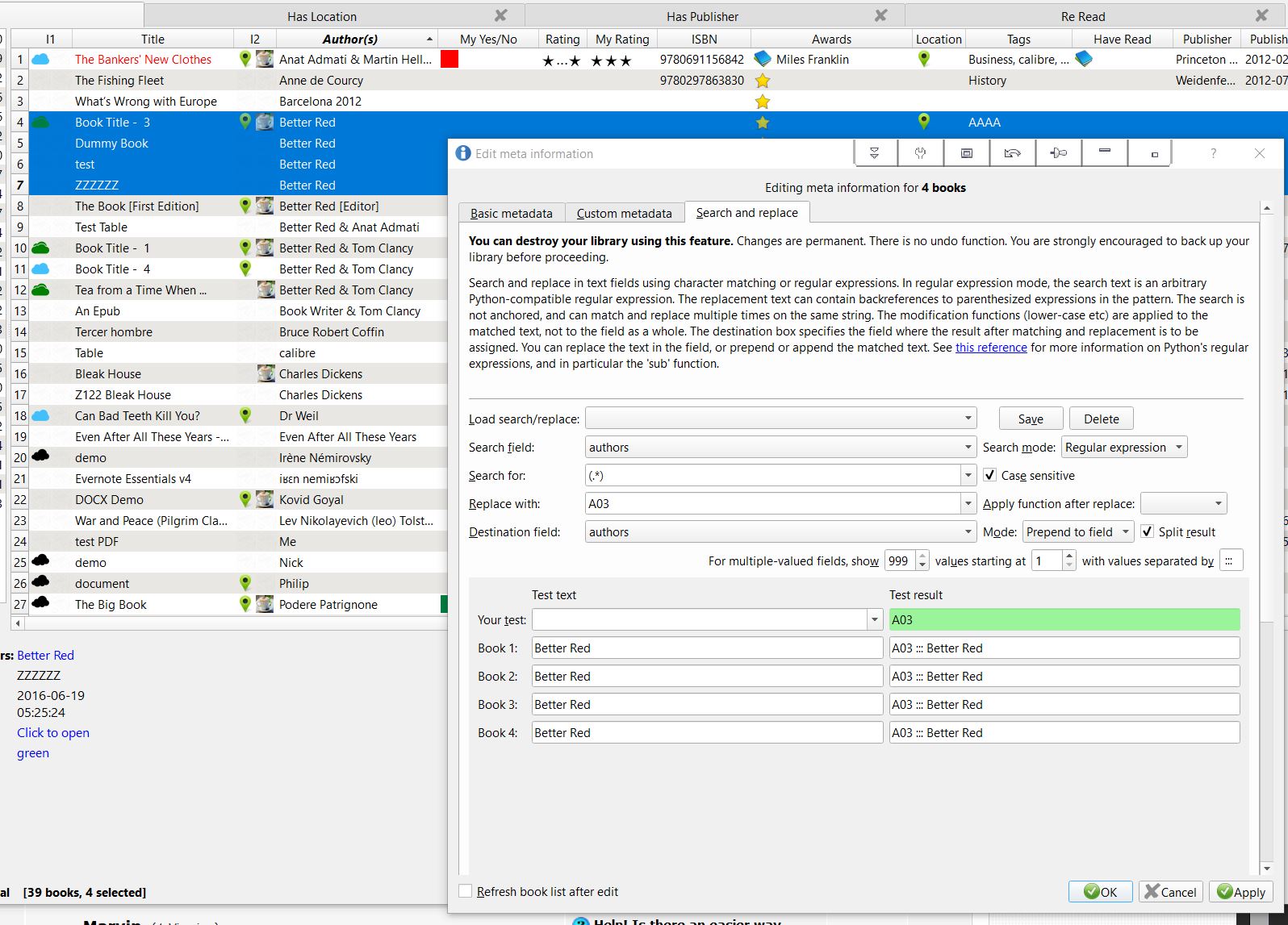

Did you try setting the Search and Replace->Mode selector to Prepend to field See attachment
went in and messed around with this on some test books, and it was exactly what I was looking for! thanks for the screenshot, it was very helpful, and for the suggestion & clarification

In 2020 (5.8.1) the suggestion by BetterRed was no longer doing what the OP asked, but it's VERY close. If you add an extra period to (.*) so it shows (..*) it works. Also you don't need the (). Thanks a ton!
Edit: So 4 months later. I need this same thing and realize I was not very clear.
To add another author to a bunch of books. Working as of 5.17
Bulk Edit Metadata -> Search and Replace
Search Field -> Authors
Search for -> ..*
Mode -> Prepend to field
