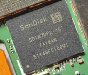

Do you have a picture of what the memory module in KV looks like? Thanks
Chiming in Late, but my KV is open for a serial jailbreak, It's BGA so it's not easy to replace
