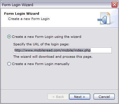

  2. In the Form Logins dialog select "New...", this will open the Form Login Wizard.
  3. The wizard asks you to specify the login page, use https://www.mobileread.com/mobile/index.php (1st screenshot)

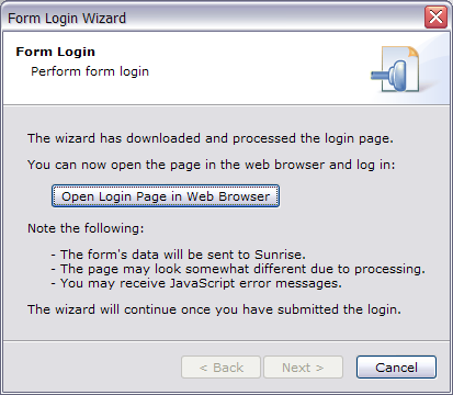

  4. The wizard downloads and processes the page. You will be asked to open the login page in the web browser. (2nd screenshot)

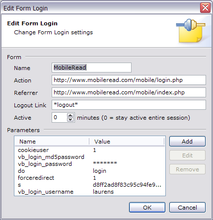

After completing the wizard you have a new Form Login which you can associate with a document. The settings should look as shown in the 3rd screenshot (with the exception of the username/password)

  3. Pick the "MobileRead" item from the "Form Login" field. (This is the Form Login you created earlier.)
That should do it! I realize that Form Logins might be a little complicated, at least initially, but I don't think I can make them any easier to use.
The Form Login Wizard may not work with every form, the processing that goes on behind the scenes might break some JavaScript logic. If you know how HTML forms work you can set up the parameters manually.
