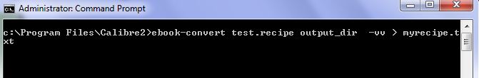

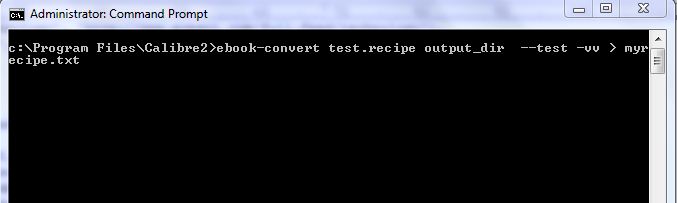

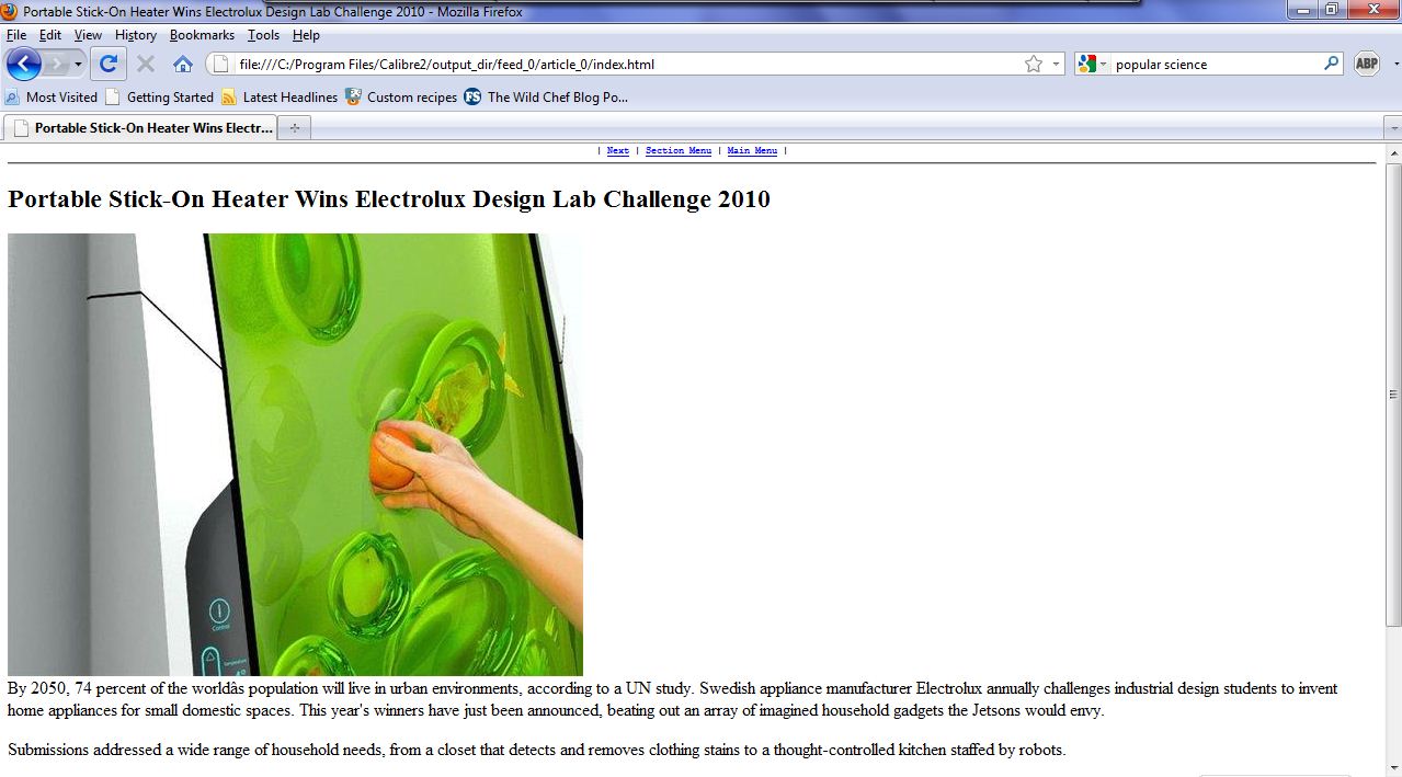

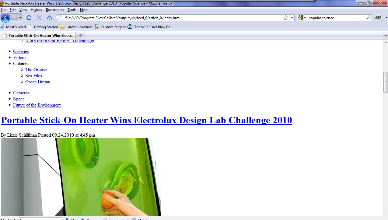

Here are some snap shots that should explain what I'm seeing. As far as the news.py I tried to find that file without any look. The closes I came by looking in my myrecipe.txt was a file that was suppose to be in
\site-packages\calibre\web\feeds
I went there and the only file that I seen in there was news.py0 I tried to open that file with ultra edit and it is binary..
thanks.
