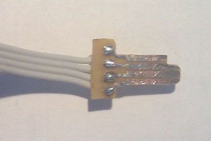

Hi,
I thought i might as well post the mechanical design I use for my Kindle serial plug since the other plug designs i have seen here do not contain the notch you need to insure a good connection with the 2 serial pins.
You can see why you need the notch when you take apart the socket the K3 has. I wish i had done that at the start because i had lots of headscrating moments why the damn plug would work one moment and not the next.
It also led me to discard a perfectly good sparkfun level converter as "broken".
Right now i use a Bus Pirate to interface the kindle.
To etch you need the following:
Etching solution (natriumpersulafte)
a single sided copper clad board (a really small piece of that board really)
a laserprinter
a page of *inkjet* glossy photo paper
an old toothbrush
print the .brd file with EAGLE in Black+White to the paper and iron it to the copper side of the board. The printout should look like the png I included.
use some warm running water and the toothbrush to remove the paper.
etch the board in the etching solution and then cut the board down like the one in the attached photo. Your board will also be probably too thick. you need to file it down by 1/3 if you have standard thickness board.
after that attach a suitable 1.8v serial adapter or level converter and enjoy.
-blkhawk

thanks blkhawk. Your method of etching sounds much easier than ones I've found online requiring UV lights and transparencies - that is, unless thats what you mean by "etch the board.."
To use the bus pirate for the serial port, how do you configure it? Based on reading I've done, seems like you need to use the open collector and UART mode and feed the bp a constant 1.8v source? Do you have an easy suggestion for the 1.8v beyond a bench supply?
As should be clear I have very little electronics experience. I see there's now a much easier way to hack the kindle 3 but this looks like a good way to learn and have some fun.

The laser printer toner method is good for small runs of reasonably simple PCBs but if you want to do more then you'd want to use photoresist and a mask with UV exposure.
The Kindle supplies 1.8V on one of the plug connectors. Picture here.
no, I meant by etching put it in hot etching solution and stir it.
yes, start UART mode with "m3" then choose baudrate "9". the Rest of the settings are default. Enable pullup Resistors with "P" then Start the transparent UART Bridge mode with "(3)".
You can get the constant 1.8v directly from the kindle. the shortest pin on my mask has 1.xv on it.

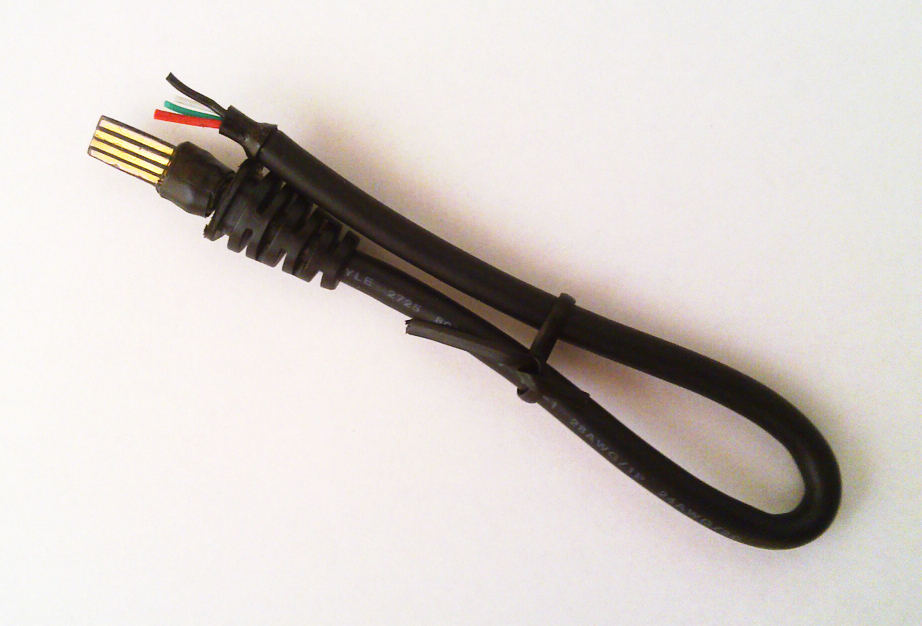

Sorry for bumping an old thread, but if anyone can make a plug for me (even better if an entire cable), I can pay them. I would love to have one for experimenting with the Kindle 3, but I don't have any of the materials to make one.

This one flies to you, yifanlu.
Thank you so much! Now I can do some of the kernel hacking that I wanted to do, but was afraid of bricking.
