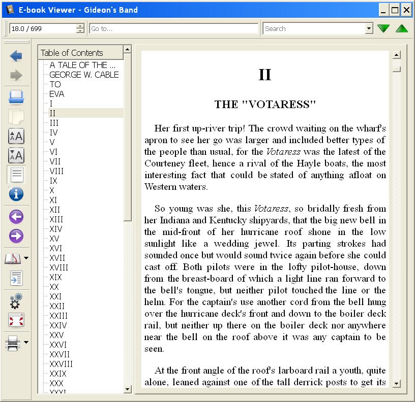

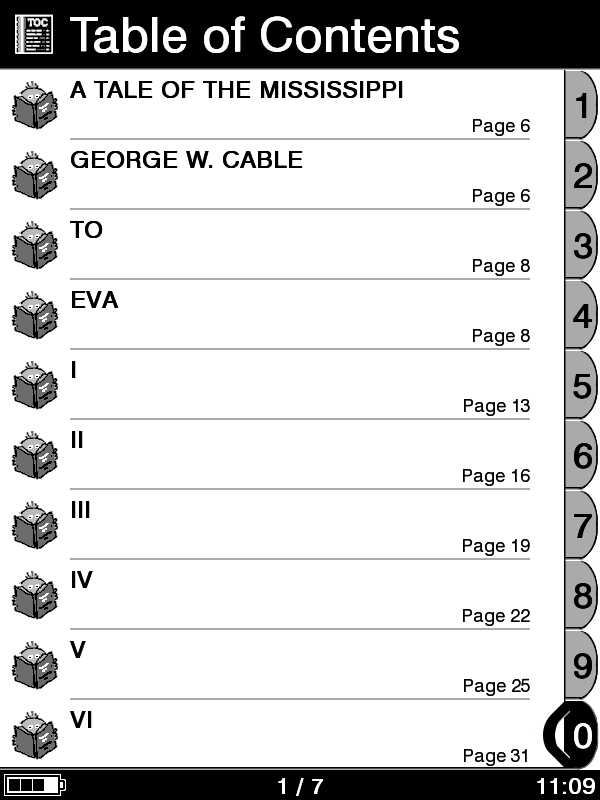

Firstly, sticking with the GUI for the moment. I've converted the HTML to epub using option 2 of the three I listed above.
I have attached a screencap of the resulting epub when viewed on the PC using the calibre ebook viewer.
When I open the TOC panel (left-hand side 7th button from top), I see a list of all 63 chapters. If I click on one it takes me straight there. Screencap shows Chapter 2 selected.
Once sent to the PRS505 using GUI 'Send to Device', I select the book and press my 505's TOC button (button 5). It lists all the chapters and I can select whichever I want. I have also attached a screencap of the 505's TOC.
Which of these differs from your own experience?

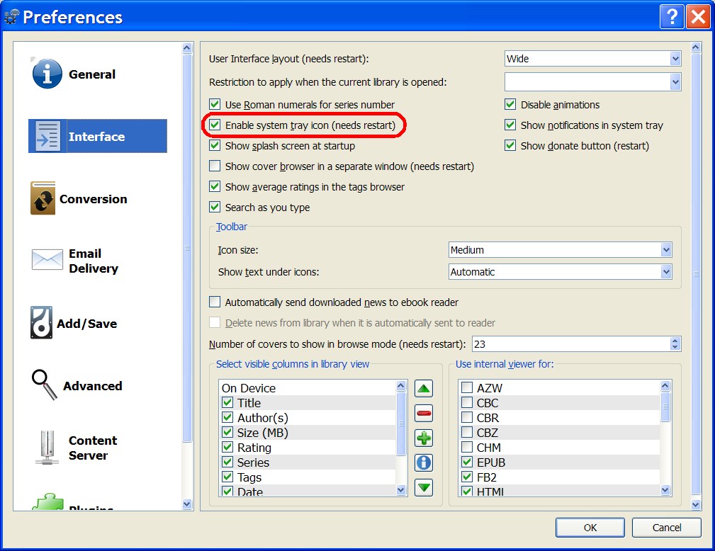

Calibre doesn't leave any processes running if you exit the program.
Of course if you have the Enable system tray icon feature checked under Preferences - Interface, then you have to use ctrl-q to exit the program. Just clicking on the big red X just minimizes calibre to the system tray. See attached.
You can also go to Preferences - Advanced and lower the number of worker processes.
