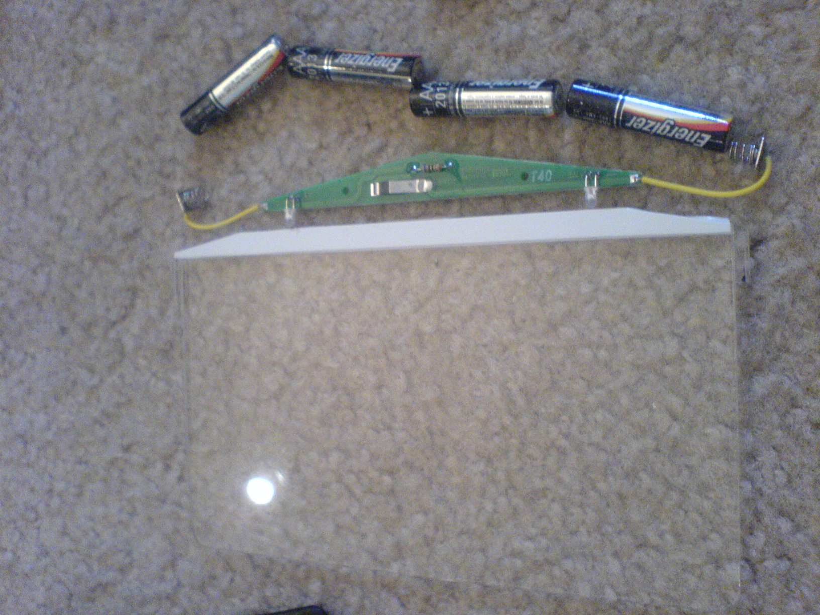

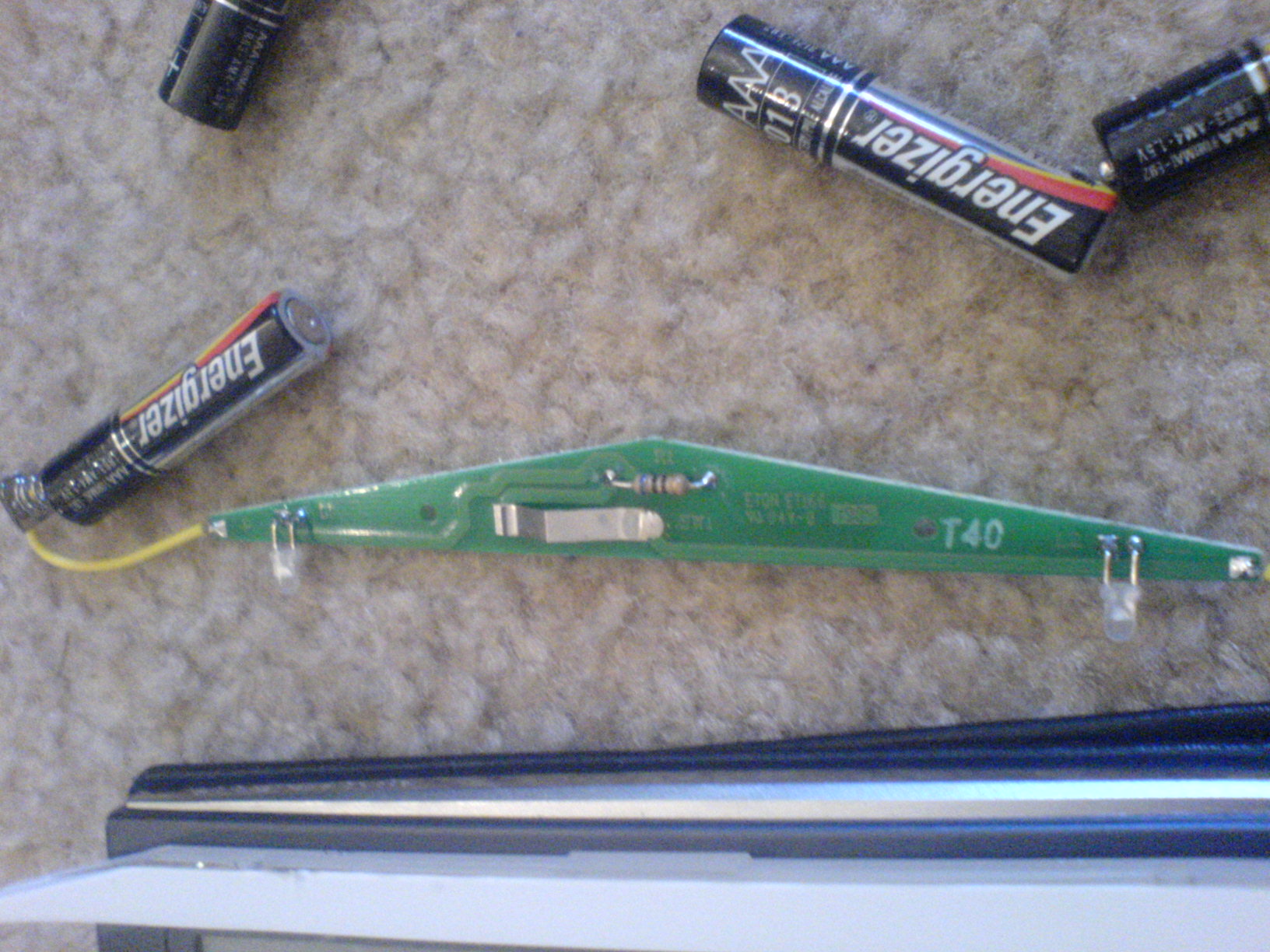

Motivated by lack of available custom booklights, I am making a custom lightwedge. The idea behind it is very simple. The lightwedge is simply two LEDs, a resistor and 6 volts. the part that costs $25 is the light guide. The light guide has tiny angles in the casting that reflect a tiny part of the light evenly over the page of the book.

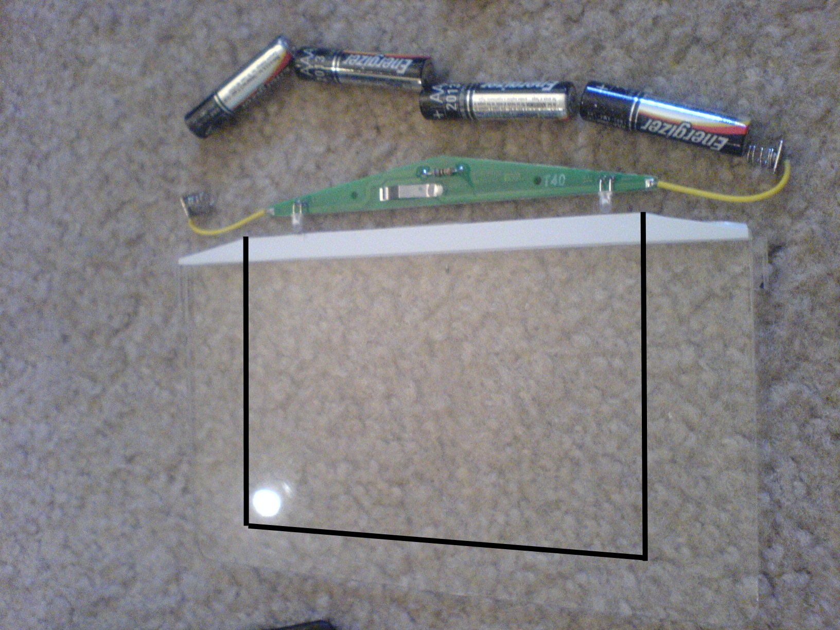

My plan is to cut the lightwedge to the right size (as detailed in the third picture lightwedgemode.jpg), add a new switch and a batter pack that clips onto the back cover. I'm going to try to use the magnets in the ebook to attach it, but I suspect they won't be strong enough to hold the heavy plastic.
I don't think it will be very hard, but I don't have the right tools right now to really get started.

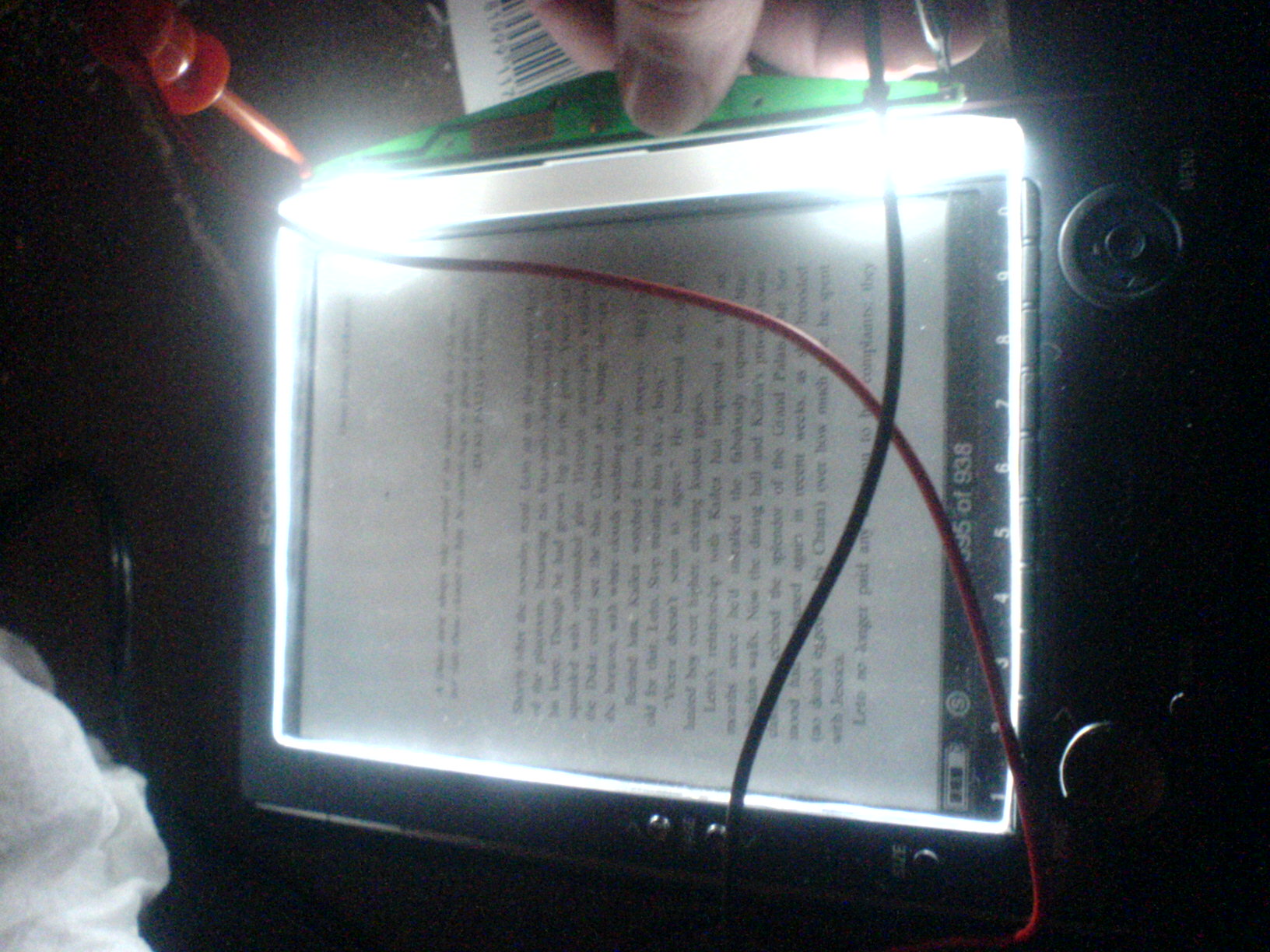

Well, I decided to work with what I have. A Dremel rather than a bandsaw. i'll have to say I'm happy with the results sofar.

Can you cover the LEDs? You seem to be getting quite a blast of light in the face there. That makes it too distracting to read comfortably!

I put the thing together last night and read for a couple hours. Those 4 AAA batteries and the lexan add about 4 ounces to the weight. I had noticed the lights to the face problem prior to bed. I used masking tape to cover the LEDs, Yvan.
Still needs a new switch and I need some strip aluminum to screw the thing together structurally. I seriously doubt that two neodynium magnets by themselves could hold JUST the tapered lexan piece in place, much less with full battery pack and things. It's going to want to pull off from the left side of the screen, so I need to add a hook that will grab the reader from the left and latch on the right with the magnets.

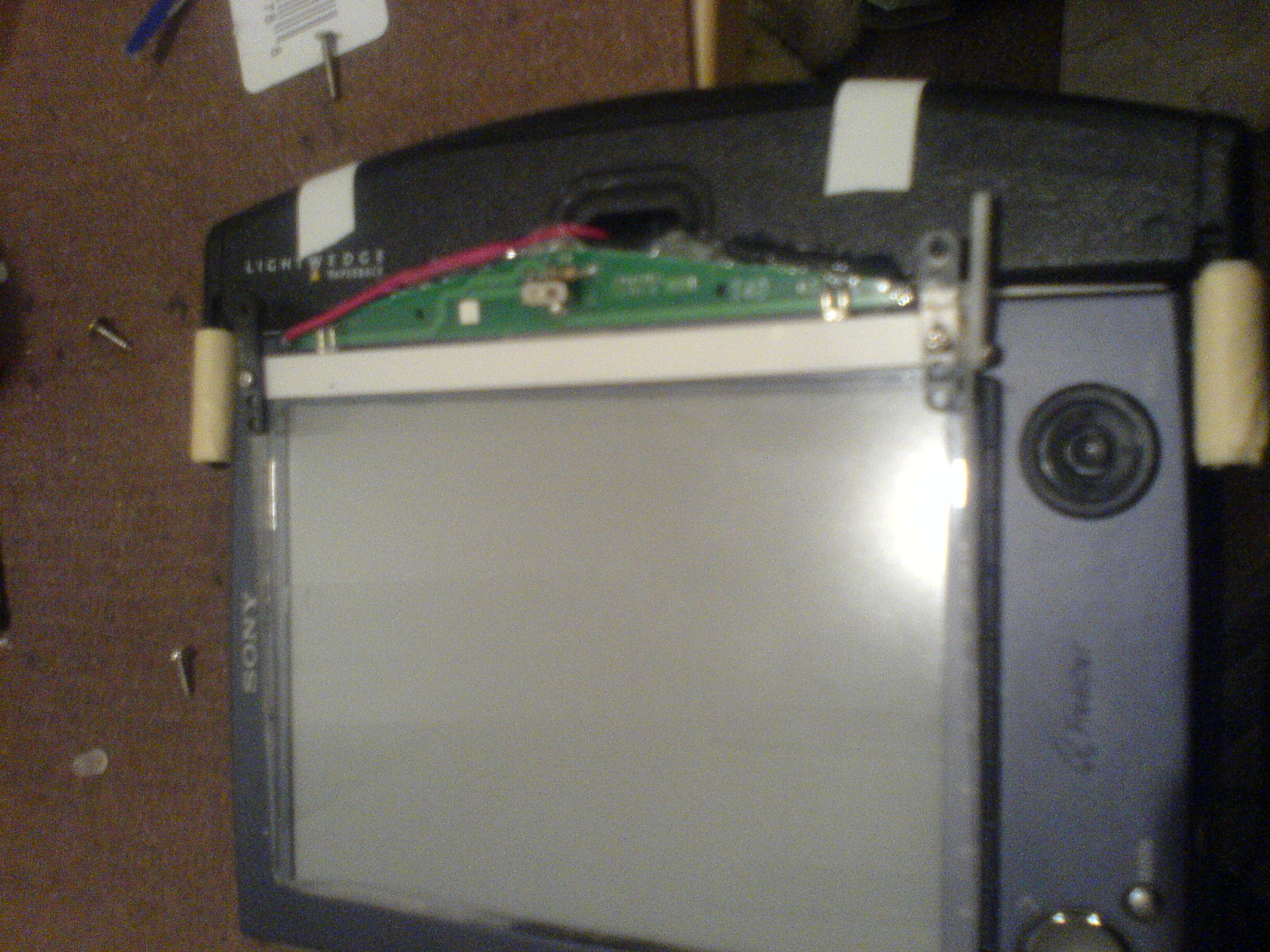

Yes, it was my inspiration to get off my butt. I have pictures of the final design, but my card reader isn't working properly and I can't get them right now.

Yes, that would be great! But, I've been rethinking my design and I think I can eliminate the circuit board altogether in a future revision. I've come pretty far with this design and think I might need to start with a new lightwedge for version 2. I think obelix is correct in abandoning the 4AAA batteries and working with a mobile phone battery.
By simply hot-gluing the LEDs into the lexan and integrating the battery and switch into a "backpack" like Obelix, the magnets could probably be used to attach the lexan to the reader and it would look VERY sleek.
