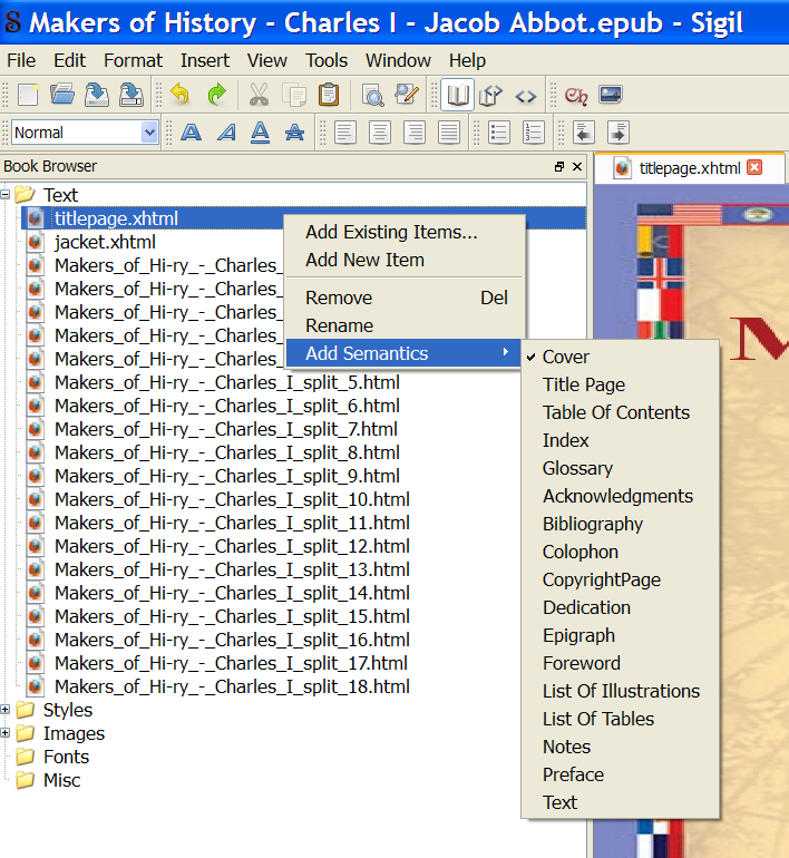

Originally Posted by mumdigau View Post
What do you mean by 'properly identify'? And how do I check if a epub file is OK on behalf of this?
Until this version the only way to add a new cover was by converting the file, even epub to epub sufficed. As of this version ebook-meta can change the cover if it is already properly labeled as a cover inside the book. You can open a epub in Sigil, right click on the titlepage then go down to Add Semantics, if cover is checked then this was properly set.
I believe this means that if the cover is not properly set then the only way in calibre to add the cover is to convert the file.

Thanks for your explanation. Indeed, the epubs I'm going to add to the library haven't their cover properly set. If I do that in Sigil then the cover will be replaced by ebook-meta.
On the other hand, I tried a simple epub2epub conversion with ebook-convert (no options set besides --cover). This adds the specified image as a cover, the original image is still there, most probably since it isn't properly set as cover, and the new added cover looks somewhat strechted. The old image can easily be removed in Sigil, but in any way I have some manual work with Sigil (apparently there is no batch mode). That makes both procedures more or less infeasible, because I want to add more than 2500 ebooks to the library.
At the moment, I see best chances in adapting the conversion process, i.e. replacing the image (not shure if this is possible), and avoiding that the new cover get stretched (that should be possible through properly set conversion options). Since ebook-convert can modify metadata, too, I could do all my changes in one go.
There are two settings at play here.
1. In the GUI there is an option under Preferences - Conversion - Structure Detection - if you check remove first image, then the first image will be removed when converting.
2. The image is slightly distorted because it is now rendered as a .SVG image and will stretch to fill the screen. If you prefer an unstretched image where the aspect ratio of the image remains in tact then go to Preferences - Conversion - Epub output. Here you will find two options that will do this. The Preserve cover aspect ratio, leaves the file as svg and it will not stretch to fit the window and thus not be distorted. The other option is to check No SVG cover, this will produce a jpeg for the cover that will not stretch to fit either. Some readers don't handle SVG images and this last option is primarily used for providing covers for those readers.
So to get what you want, run the epub to epub conversion with remove first image and Preserve cover aspect ratio checked. If these are your saved default settings in the GUI they should affect the ebook-convert too.
