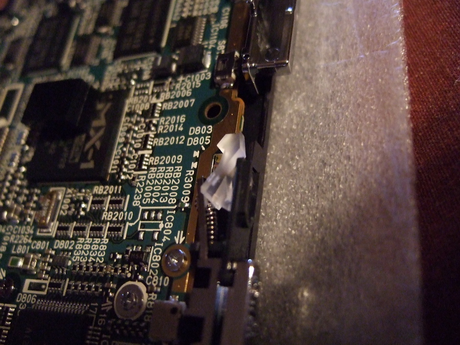

Where I stupidly took the initial thread revelation of needing to press the power button, and the fact that I could see no other holes to stick a paper clip in (it was still in its case), and i didn't have a manual to hand.. i ended up sticking the paper clip in the hole next to the power switch.. i'd forgotten that just earlier that was what was telling me if it was being charged etc.. ie. an LED hole.. anyways i pressed around in there gently feeling for a press switch.. i could feel how the power button interacted with the hole a bit and in the end i pushed it too much and the power button is now a bit sticky and doesn't return to the top..
I've clearly pushed the spring off of a lever, or possibly broken something that it was connected to.. hopefully the former would lead to a quick fix as it'd be a case of just putting it back on again.. the latter would be unfixable.

You probably just popped the spring off the slider switch, jimbobuk, it's not that difficult to get back on (as long as you didn't actually break anything ), just a little finicky is all.
As for taking it apart. You'll need to remove all the screws you see on the outside (including the bottom edge), and the ones you see in the card slot. I think one of the disassemblers who posted pix described that in some detail.
The only really tricky part about putting it back together is getting the screws near the magnets back into their holes, the magnets want to grab them away, you see. Needle-nosed pliers are a big help there.

phew.. I've fixed it.
Wasn't exactly easy, frustratingly i don't have a good phillips (cross headed) screwdriver of that size so was forced to use a flat bladed one that had a small chip in it making it small enough to fit into one of the slots.. made it hard work, and it grinds the head down a bit.. i MUST get a good pair of tiny screwdrivers, always a problem when you need them.
I had pushed the plastic LED light conduit out of its hole, which had kinked the spring and made it sticky... i'll attach a couple of pictures i took.. thanks for the other pictures and advice on that thread above.. felt vaguely safe knowing where i was going with those instructions.
