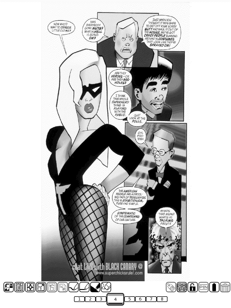

Here's a screen shot.

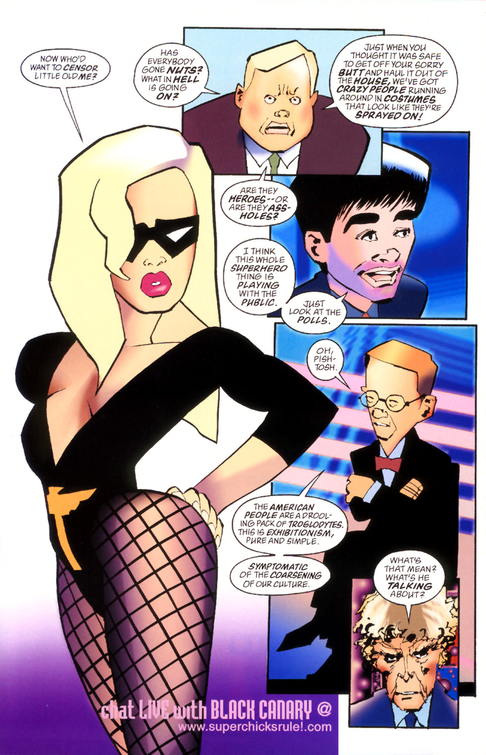

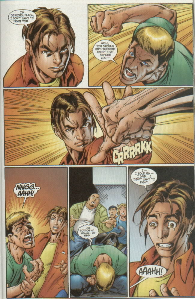

Thats cool... One question... What did the original look like...? Ie, how much alteration did you have to do...?
Atually The lib don't alter the jpegs itself i made the code (using standard java libs) that scales down the jpegs and set them as grayscale (the version i used for that pdf was bugged and generate a wrong aspect ratio btw), so from that point of view that is fully customizable .
I've attacched a couple of the source jpeg to let you evaluate the difference.
seems good
