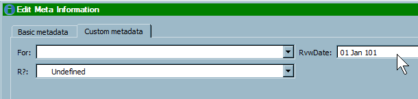

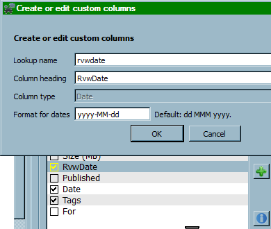

I took a couple of cropped screen shots to show what I see [1] in the columns editor and then in the book editor's custom screen. I hope they have been uploaded correctly here. NOTE: I switched to yyyy-MM-dd in my most recent attempt to fix things.
Don't know what to say. I'm running 0.7.8 with completely updated WinXPSP3 with plenty of storage and memory on a decently powered machine. I DO program for a living and I run a Nexus database server. But nothing SQLite and that's what I understand is used by calibre. It's possible that the database server from AbstractSpoon's ToDoList product is SQLite and is interfering. But that's not running full time and hasn't been during this process.
0.7.8 DID get rid of an intregrity check issue that has plagued me through the last two or three updates.
At this point, I don't find it hard to believe that it is machine specific rather than a problem with calibre. But I'm at a loss as to HOW it is still functional, yet producing these anomalies.
GM

I haven't been editing through direct cell editing of the main form. When I do, I get the 'normal' behaviour accounted for by other correspondents. Although i DO find it impossible to wipe out the date with either the backspace or delete keys.
No, my problem is in the metadata's editor custom data page.
GM
PS: It comes up undefined and changes to the year 101 date shown in the graphic upon clicking the field.
