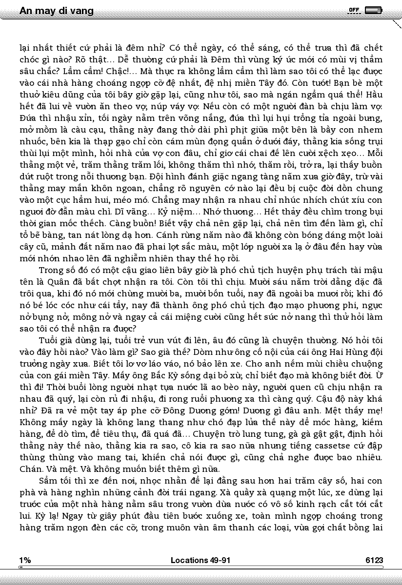

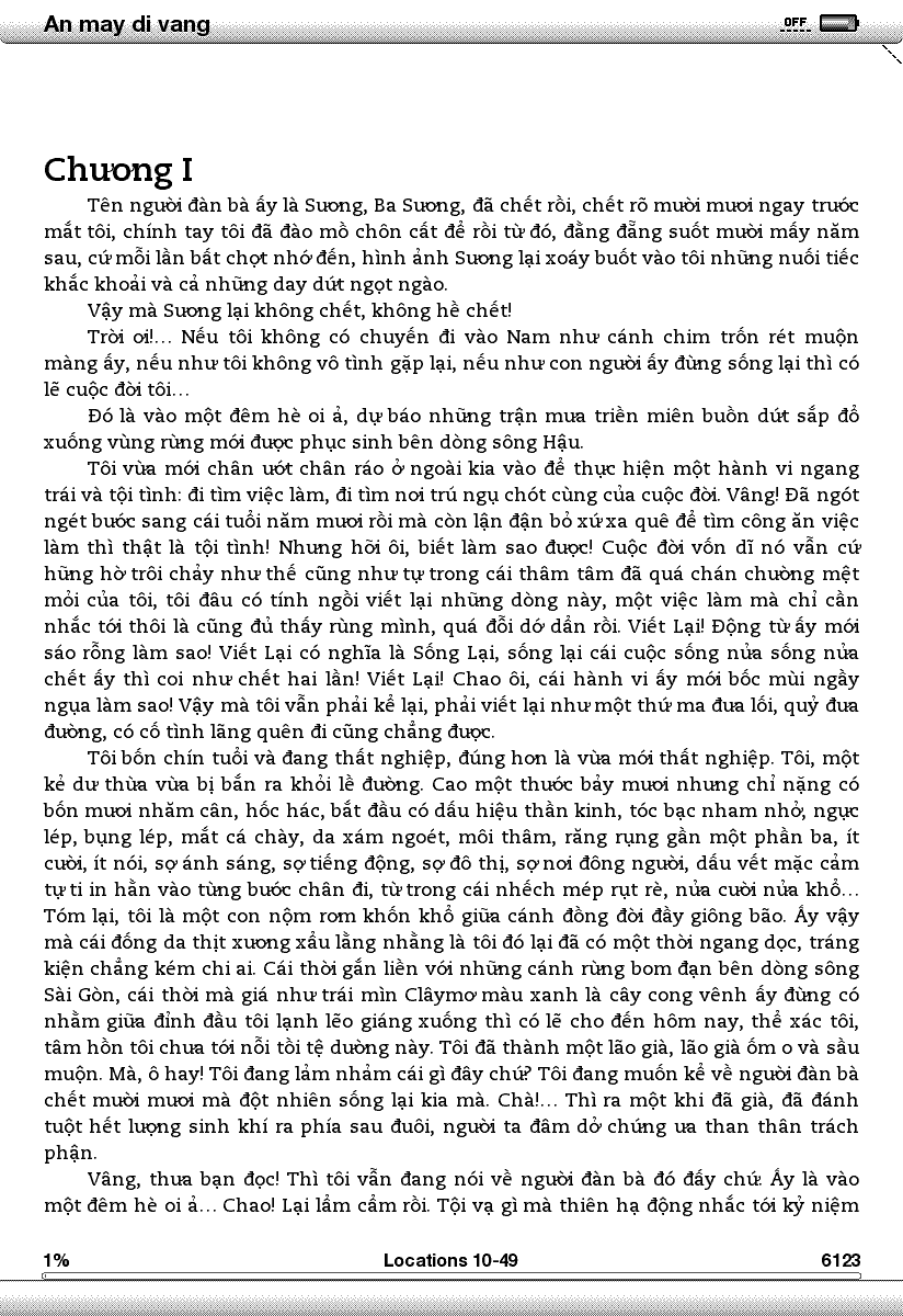

I dont know what Vietnamese is supposed to look like but I loaded the .prc into my kindle dx and took two screen shots.
The wierd thing was how slow the dx was while turning pages... much much slower than with other books.

Thank you so much. It displays the file correctly. Cant wait for the kindle dx graphite. Oh, regarding the turning pages, I think kindle is faster then Soney 900, not sure...
