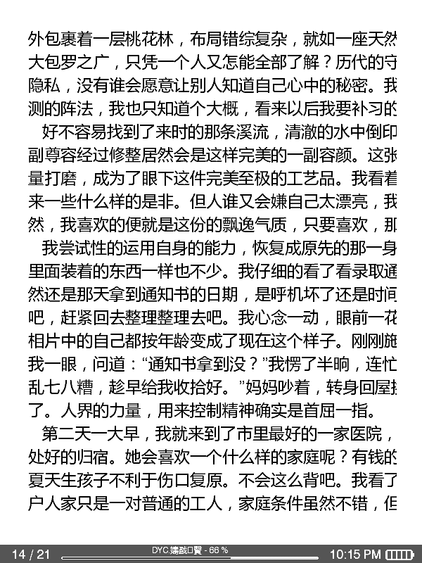

I just got my pocketbook 360. I love everything about it; there are so many features to explore. BUT I can't get one important thing to work.
I have downgraded my firmware to 14.2 and installed the fbreader180 v0.92. When I read some of my Chinese epub files, the words at the right edge are cut off. I have tried to change the margin, but it still doesn't solve the problem. I noticed that it's not only one word that got cut off; it seems like a part of the sentence is missing. (Please see attached screenshot)
I have tried to use Adobe as well, but I am still trying out the hacked version with Chinese fonts, but so far I can't figure it out yet. All the Chinese words are still question marks.
Anyone has any suggestion??

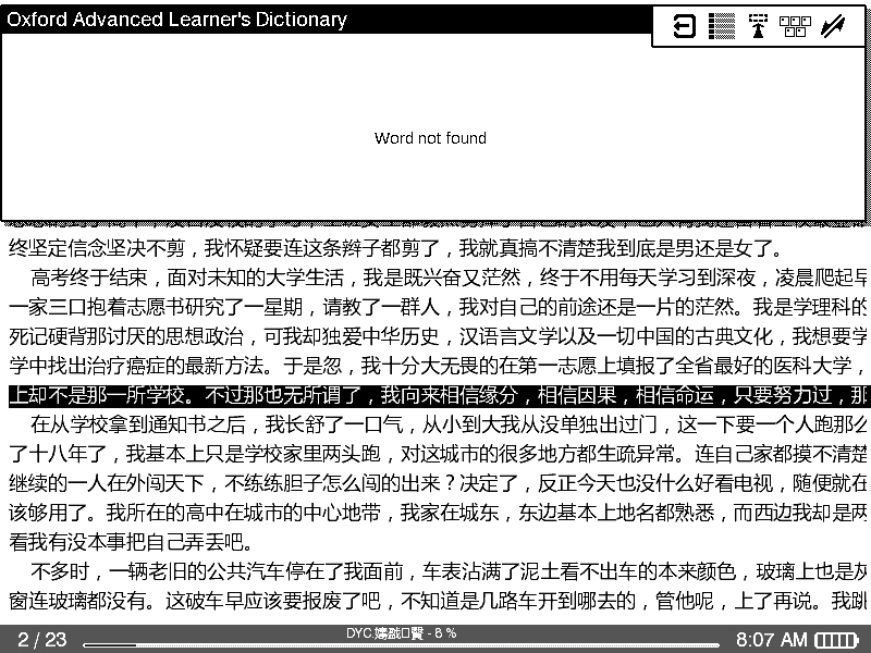

I tried to use the dictionary mode, and just as Zel said, the dictionary highlight the entire line rather than individual word. Please see attached screenshot.
In this case, the software clearly interprets the whole thing as one word, hence the displaying problem.

I am pretty sure my epub file is fine, because I have no problem reading it with my PRS-505; no words running off the side.
mtravellerh: I will PM my epub file to you.
Thanks!
