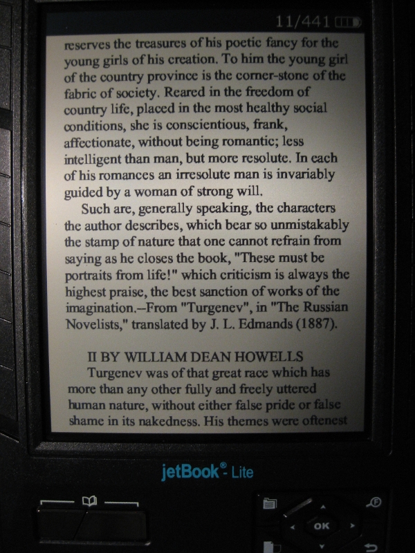

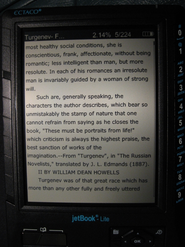

GhostHawk - what do you mean pdfs are converted to plain text?
Here are two pictures of my JBL screen. One is plain text the way the JBL displays it- and it displays rtfs and epub files the same way.
The second is a pdf. It has 1. Times New Roman Font (unavailable on JBL) 2. A margin on the left (unavailable on JBL txt, rtf, epub) 3. Single line spacing instead of 1.5x (not settable in JBL txt, rtf, epub). In short, it looks like a real book. To ME, it is a vast improvement. Maybe to some, it doesn't make any difference or they can't see it.
So since you can only control formatting by using a pdf file, it seems to be a good solution. But to go back to my original post, I may read this pdf file for 5 or 10 pages, then all of a sudden I get one page where the font gets bigger and the margin goes away. Then the next page goes back to proper formatting. I guess I did not state this as clearly as needed.

Ok, so let me get this straight. You're actually bothered by the font style? You have to have such and such font or you can't read it? If this is the case, by all means spend $500 on a unit with more features. I don't mind.
I've only read one thing on jbl with pdf format. It was a short story, so it wasn't long. Even then, I didn't notice the inconsistent font sizes that you said. I'll upload a longer pdf file and see what I'll find. I'll get back to you on this.
The reason we're recommending you against using pdf is because of the format of the page. The screen is small enough. To any normal person, it's more comfortable to read a font bigger than ant size. That's what you can do with the other formats. You have 6 font sizes to choose from. With a pdf file, the only way to make the text bigger is to increase the view size of the entire page. That means that you have to scroll the page right and left and up and down to read. May be you're comfortable with this, but to the rest of us, it's downright annoying.
But again, if you want to spend more money on a unit that you have many font styles to choose from as well as a bigger screen to comfortably read the pdf files, you go right ahead. I don't mind.
Edit.
Can you post a picture of one of these pages when the font size fluctuates?

The font sizes kept changing because jBook tries to resize the PDF to fit the screen, based on some algorithm. The best way to keep font sizes consistent when viewing a PDF file on a jBook is to use the zoom level setting, say at 100%, 200%.
