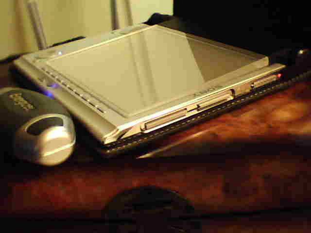

I don't own a PSP charger and really don't want to throw good money after bad. I have an Energizer Cell Phone charger that outputs 5VDC and rigged a cord that connects it to the 505 (see pic below). The charger is working, you can see the reader's red light is on.

Does the picture above show your actual device?
Because I see red LED light which indicates that the device is charging.
If that's the case, wait for few hours and it should work again.
I had my screen stuck once, but resetting the device helped so I would try that as well, don't give up so easily.
