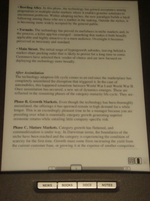

Thanks vvv! I had a quick test. I found it very easy to create nice looking pdf or htm files, which fit my iliad!
A very good feature is that the screen is used to its full extent. With htm lines wrap to screen, when scaling up!
Files convert well to text files. I did only some testing with import formats to avoid edit need of the imported data. The only thing I haven't managed so far is to get embedded pictures with my files. If I can find a way to do this, this program is a very nice tool indeed!
I'll continue with testing on weekend.
Enclosed a sligtly unsharp shot of a first result.

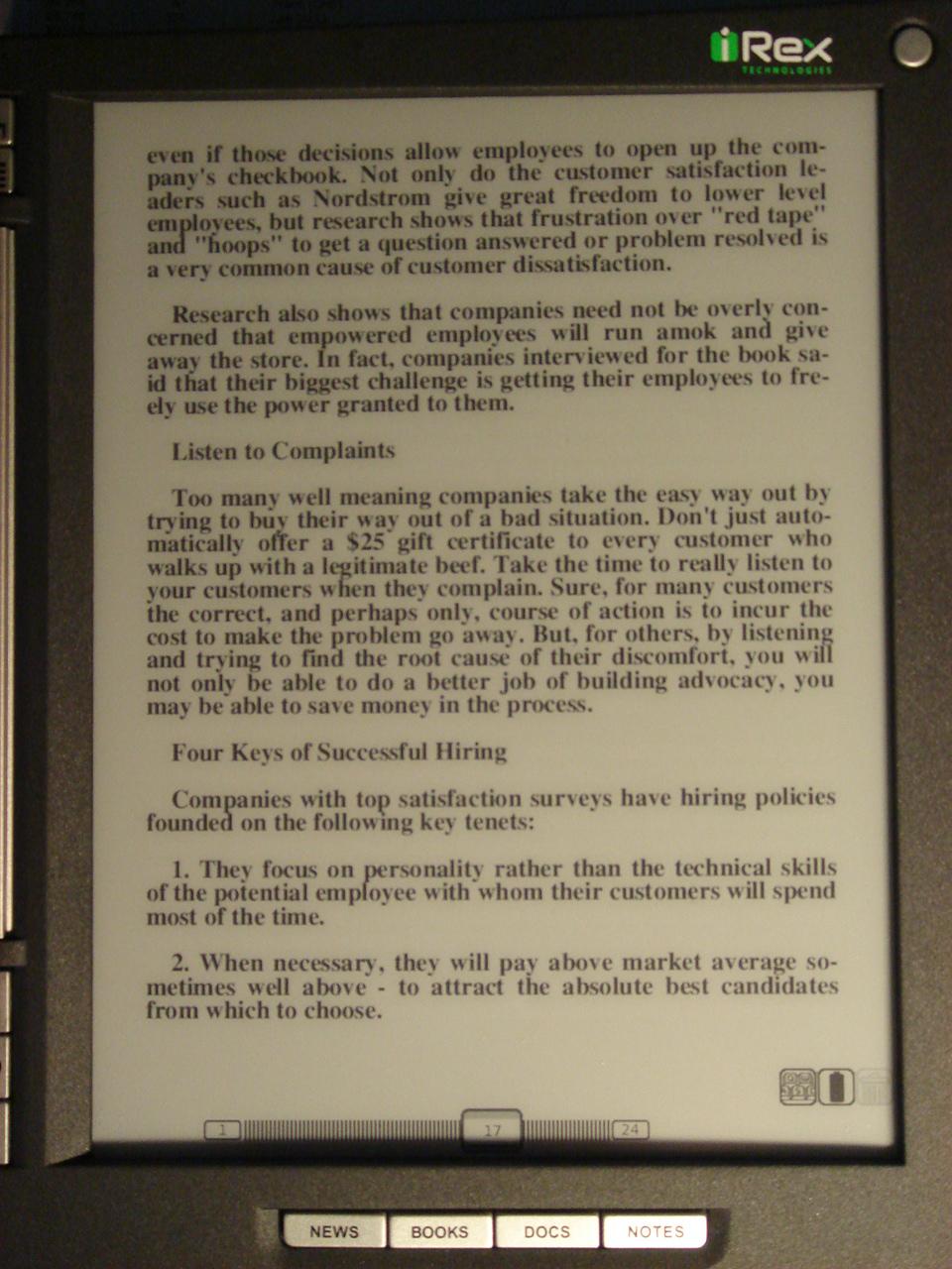

Importing Word rtf files work best for me - no reformating needed and pictures are included!
ID:	1542   Click image for larger version

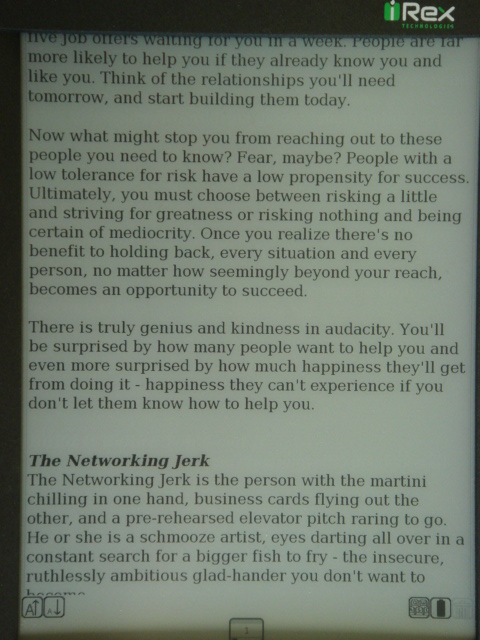

I think DHer is on the right track.
Anyway look at the inclosed picture of the html transformation. No margins.
This file has a border line left and right - so I get small "margins" on left and right. Font may be scaled. Top and bottem lines are cut. The cut lines can be read on previous and next page. So a part of the content shows up twice. With exact page turns and included embedded pictures this format would be perfect?!
