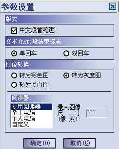

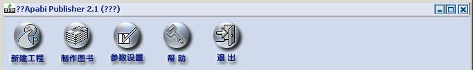

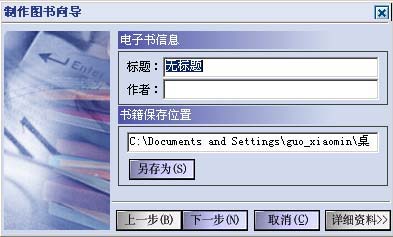

I have made some screen shots of the program. Just in case someone wants to help translate the program without installing it.
From translating the manual with Google and using the program I have a general idea of what these dialogs are about, however I have still not figured out each option in the settings dialog. Also I know that the Create book dialog has a fields for title and author, but do know which field is which.
Once I have the last info, I will make an English manual and post it.

edit:
i succeeded with creating a book containing only one jpg.
the upper filed seems to be title, the lower one author.
(apabi reader displays the upper field and in the empty file it's called blank_pages)

Short How-To:
1. Install the program (next, next, next, just like every windows installer)
2. Start it
3. Add by double-clicking on the left side files to the right side
4. press on the 2nd button from left (seems to be something like "pack")
5. Enter Title (upper), Author (lower field) and path
6. Press the button with (N), confirm with the (A) button when necessary
and the file is created =)
Purpose of the buttons:
1st: New Project
2nd: Create the file
3rd: Options
4th: Help (Chinese, thus useless)
5th: Quit

Just tried to create a .xeb consisting of 600x600-pixel png's, and it worked. However, the pngs appear to small. Did anybody find out how to make things fullscreen? Or what the things in the option dialog mean?

@ali
In the settings dialog at the bottom, there is a maximum image width (in pixels) setting.
The predefined settings are for Ebbok Device, Palm Pilot, Desktop PC and Custom. Choose custom (last item) and type a number between 160 and 800 in the box.
