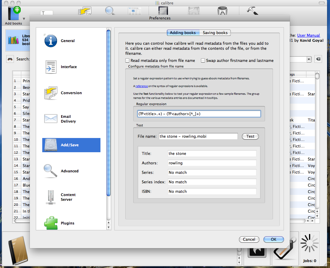

Hi everyone,
I'm not sure if this has been asked before... sorry if it has.
I want to add my book files to Calibre but don't want to sit there for half a day changing the metadata.
My books are filenamed:
Author - Series Series Number - Title
Example
J.K. Rowling - Harry Potter 1 - Harry Potter and the Philosopher's Stone
I see in Calibre you can change the way files are added however I can't seem to figure out the specific string I need.
You help would be most appreciated.
Thank you
tisk tisk... i dont recall this ever being released as an ebook
As for you question I would have to venture the answer to be yes...
You would have to edit the expression to suit your needs though I have no idea on how to do it. There is a link there that has reference expressions that you can use...
Name:	Screen shot 2009-12-29 at 11.47.07 AM.png

Thanks but that's the part where I'm stuck...
This will do it for you:
^((?P<author>([^\-_0-9]+)(?=\s*-\s*)(?!\s*-\s*[0-9.]+)|\b))(\s*-\s*)?((?P<series>[^0-9\-]+)(\s*-\s*)?(?P<series_index>[0-9.]+)\s*-\s*)?(?P<title>[^\-_0-9]+)

Thanks Starson that's sorted it
I would never have figured that out
