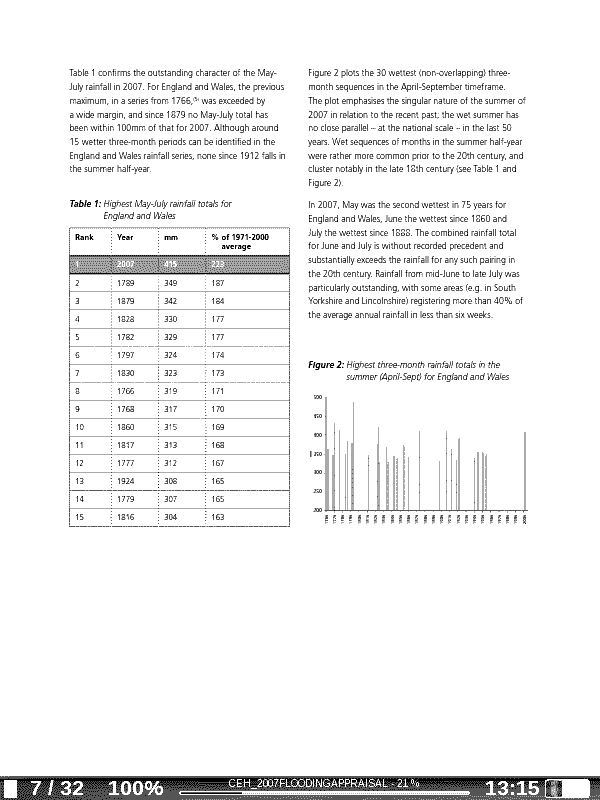

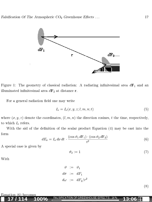

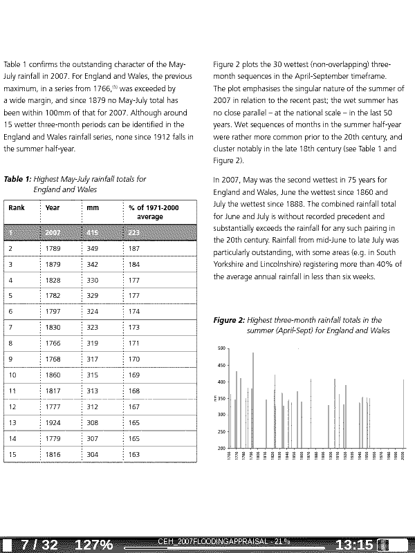

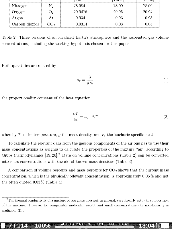

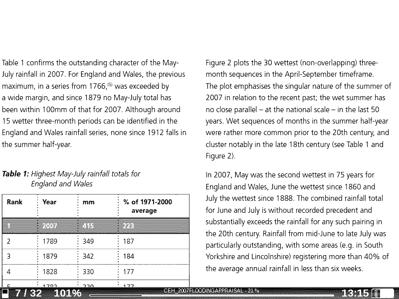

The PDF viewer on the PB 301 is the same as that on the PB 360.
So yes it has Fit to width in Landscape and Portrait, Persistent Zoom- which means if you're using fit to width you may have to change it when you change between landscape and portrait. And single column reading of course where you finish at the bottom of the first column and it moves to the top of the next
These screenshots show tables, math and graphics. I wouldnt call the PDFs overly complex bu these will show you fixed to width in portrait and landscape as well as single column reading

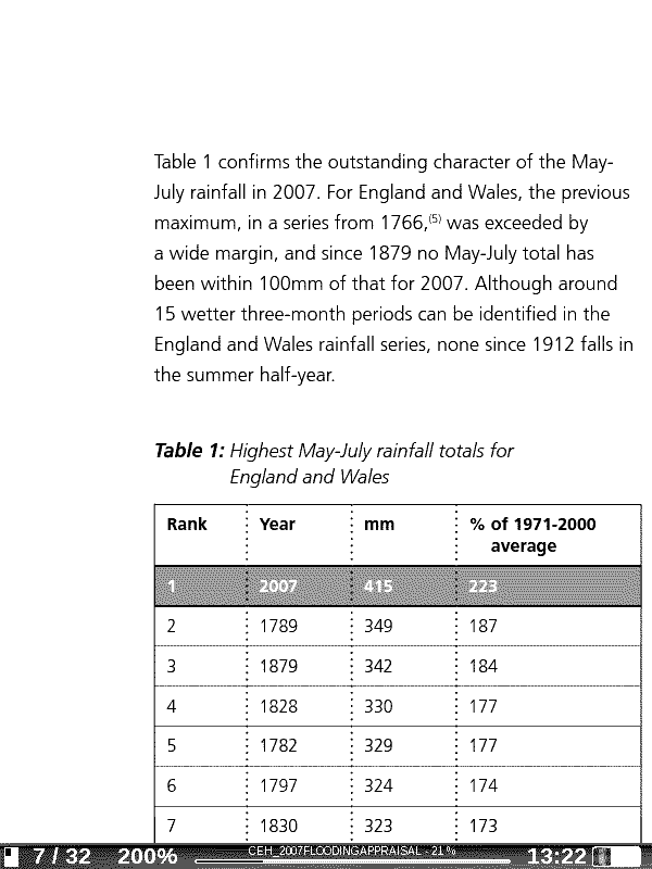

The autocrop seems to work really well. For those scanned PDF of Dejavu files I suppose that the zoom is the road to larger fonts. Can you confirm the zoom is persistent from one page to the next?
Thanks!

Yes persistent zoom from one page to the next for the entire pdf and it remembers when you turn it off/exit the pdf so you don't have to fiddle with it again later.
