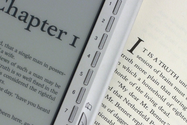

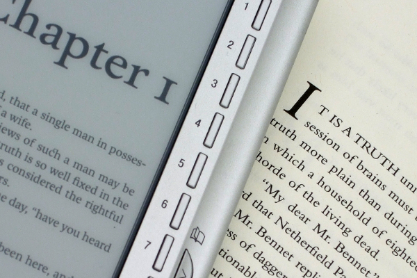

OK I just grabbed my camera and decided to take a few more quick snaps with my reader.
One consideration that must be made on occasion is how bright the ambient lighting is, and what kind of surfaces are being reflected on the screen. To give an idea of how this affects viewing, I took one photograph with a white reflected surface, and one with a black reflected surface. With the white reflected surface, the brightness of the background goes up, but the black point suffers and gives the impression of weak or even blurry text. With light overcast skies, reading outdoors may show this kind of effect. With the black reflected surface, the black point is much more readable, but the overall background brightness goes down. This is mitigated if the ambient light is plentiful.
I just want to make a point to photo geeks/snobs that these aren't studio photos or even high quality photos, just informal snaps taken with a cheap digital camera (evidenced by corner/edge degradation, so ignore the edges of the photos). I tried to keep the metering and white balance within reasonable tolerance, but they're far from good.
Addendum: Oh and also, the e-ink background is ~80% the brightness of the paperback paper in the white reflection pic, and ~65% in the black reflection pic. Not too surprising I guess, but I thought I'd throw those numbers out there.

Many thanks for posting those photos. They give me a v. accurate picture of what to expect from my PRS-505.
As I said in my first post, when I first got the reader, I was alarmed in case I'd got a faulty one. But now it's easy to see that it's perfectly OK, and that's just the way they are.

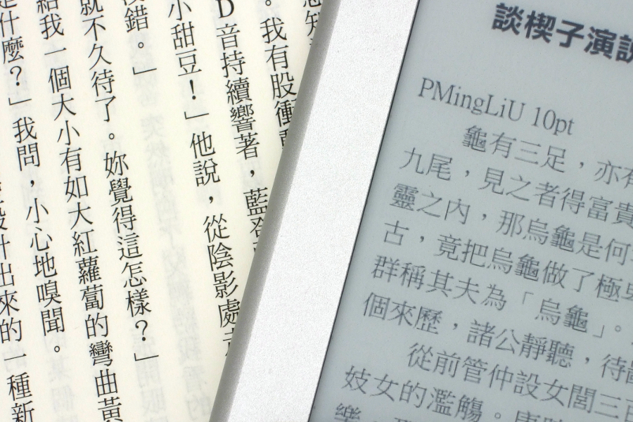

Glad to help. The web could use some more realistic photographs showing how e-ink compares to paper, since even bad pictures are often much more honest than words when it comes to markets like this.
I'm not a fan of e-ink in general, but I can tolerate it for a low-power device that I use for casual reading. I can't wait until superior alternatives come out though. I'm even willing to build all my own formatted ebooks for it, albeit only in English for the time being. I can't make very readable books in my second language (Chinese), despite a lot of effort and experimentation. I've attached a pic of some Chinese text in one of the more ubiquitous Chinese fonts next to a printed book that uses a related typeface.
If one can dismiss the hype though, ebook readers can be pleasant devices to own and use.
Addendum: Though not a scientific test, casual observation of the real-world results through photo software shows the following brightness/darkness levels of the 2 media compared. The numbers are not the same as reflectance, but based on white/black values set by a white/black/gray card used in the photo.
Paperback:
Brightness 95-98%
Blackness: 19-23%
Range: 5.2:1 (high); 4.1:1 (low)
PRS-505:
Brightness: 74-76%
Blackness: 30-35% (bold header), 40-55% (admittedly weak body text).
Range: 2.6:1 (high); 1.3:1 (low)
Like I said, they're not scientific numbers or lab data, but they're interesting food for thought anyway.
