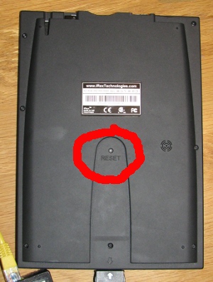

You must have missed something on your manual. There is a hole on the back of iLiad. Insert something into the hole to reset your iLiad.

I am not sure it.
My iLiad have a hold on the back. but not have any reset button can to into the hole to reset my iLiad.
I can see a inside circuit from the hole.
I don't know the version iLiad have or not reset buttion.

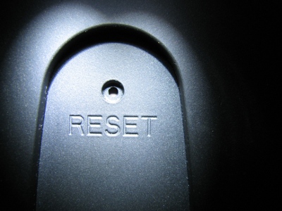

You can use the pen to reset when the Iliad hangs. You have to power it again to start it.
