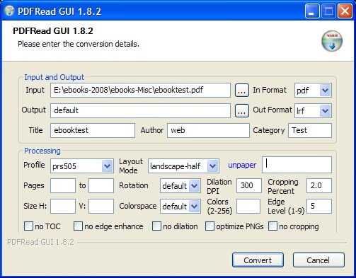

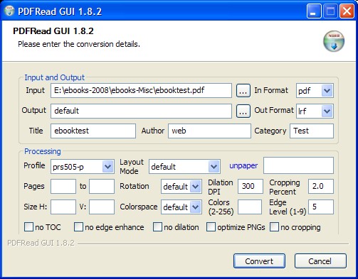

I can create well-behaved .lrf ebooks, but don't own a Sony Reader to actually test it out, but I offer you two ebooks created by PDFRead using:
1. prs-505-p Protrait profile with default other settings (see attached image)
2. prs-505 Landscape profile with landscape-half layout override.
Please ensure you can convert a very basic ebook like the one attached, then experiment on more advanced settings.
However, if you still can't get this to work, just place an empty file named 'debug' in the installation directory of PDFRead so that after any conversion the extracted images are retained.
Upon inspection of same, see if there is a bottom footer or page number or border that stops PDFRead from cropping right up to the text.
Also, check the size dimensions of the images to ensure they are within the Sony's maximum size.
ID:	37533   Click image for larger version
