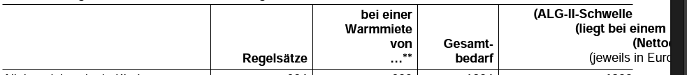

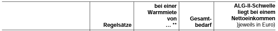

as you can see on the attached screenshots, I have a table, and when a line of text in a <th> with right aligned text is beginning with a round opening bracket, it is most likely to be dispalced.
In Screen1.pngI replaced the "(" with an ")". The rendering is as wanted
In Screen2.pngI Put the "(" again at the beginning of that line, and the whole line is moved to the right, partly outside the tables bounds

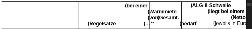

In Screen3.png I added more "(" to the beginning of other lines. Except for the first line.
In Screen4.png I added the "(" to the other th cells as well. It seems that the first line is always ok, but a "(" as the beginning of the subsequent lines triggers the bad positioning.
