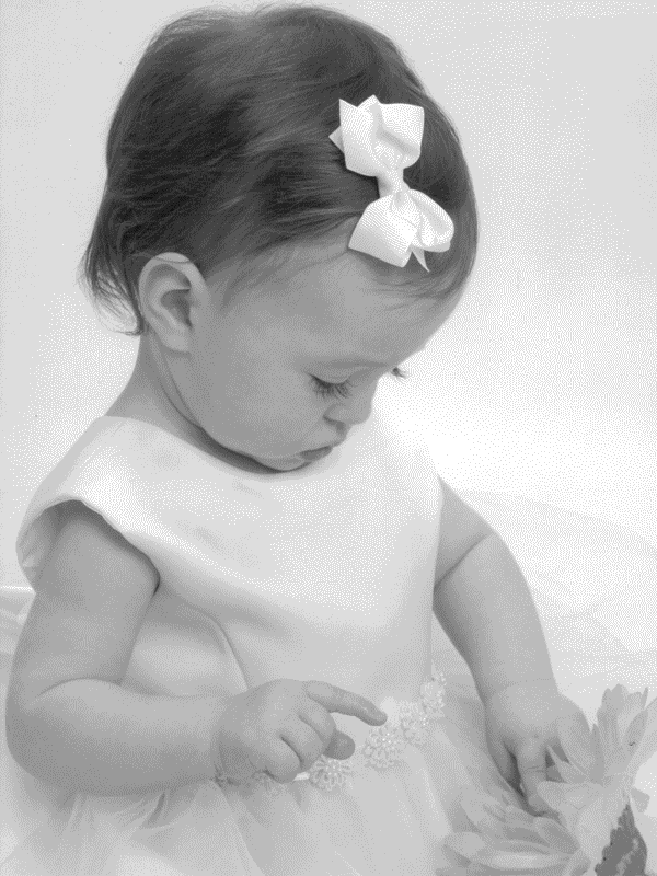

I'm hoping someone can help me since Amazon customer service offered me nothing...
The pre-loaded screen savers in my Kindle 2 look fantastic, but any photos that I add end up looking terrible. They seemed to look much better on my Kindle 1.
The pictures have these splotchy shadow looking things all over it and not at all crisp like the pre-loaded screen savers. I've tried using large size .jpg files, small ones, color, black & white, 800x600, etc., but all seem to look the same. It also doesn't matter if I have the dithering option on or off on the Kindle. I've attached a screenshot of one of the pictures that really shows off what I'm talking about.
Can anybody offer me some help on how to fix this? I'm sure it's a picture file issue since the screensaver pictures look fine.
Thanks for any advice.

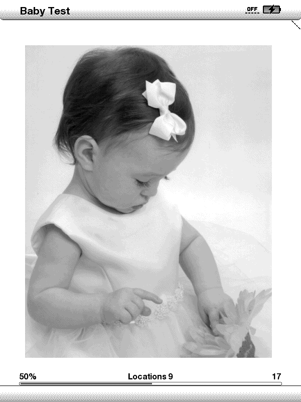

I saved the 5 MB jpeg and made 600x800 jpeg and png files from it (no other adjustments). I then used all the images (orginal, jpeg and png) files to make a photo album with MobiPocekt Creator (I did not load the images as screen savers but the results are similar except for the border around the images).
I'm attaching the photo album along with screen shots of how all 3 versions of image looked on my K2. All of the images look good to me, No splotchiness.

I agree, this photo renders very blotchy and poorly dithered on my K2 as well, and enabling/disabling dithering appears to do absolutely nothing?!
Simply resizing didn't help it on mine either. I had to actually go into photoshop, resize it, and then manually dither it by using "Save for Web & Devices..." and manually loading the K2 15 (well, 16 with two whites) color table (attached). After this, then the photo rendered as expected.
