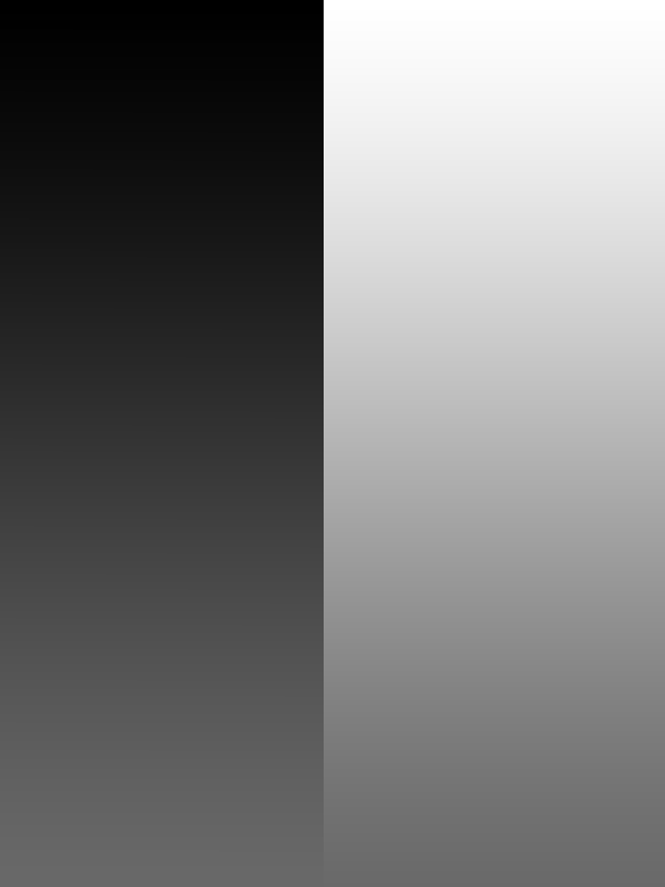

Originally Posted by FooSoft View Post
It would be interesting to figure out exactly what colors are native to the Kindle native display. I can do some testing with the Kindle 1, would be nice if someone did the same for Kindle 2, since I don't have one. That could trim file size down a bit. I'm also adding optional JPEG output to the next version of Mangle, that should help alleviate some storage issues on the space-starved Kindle 2

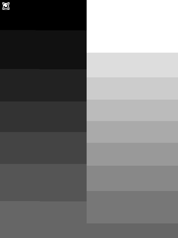

I used a 256-shades of grey test pattern to find out. And then took a screen shot of it on my K2.
Kind of obviously, the palette ends up being #000000, #111111, #222222 ... #ffffff
Not so obviously, only 15 shades of grey are rendered (both on the K2, and in the screen shot image). For whatever reason there's no #eeeeee. And if I make a 16 color image, again only 15 are rendered.

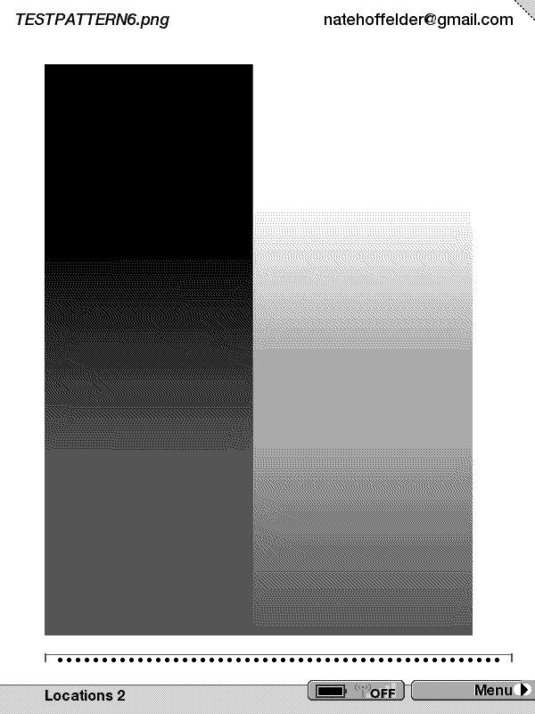

Here is the same image on the original Kindle.

Nice work with the gradient shots! Now I'll be able to predither images in Mangle, should trim size down a bit
