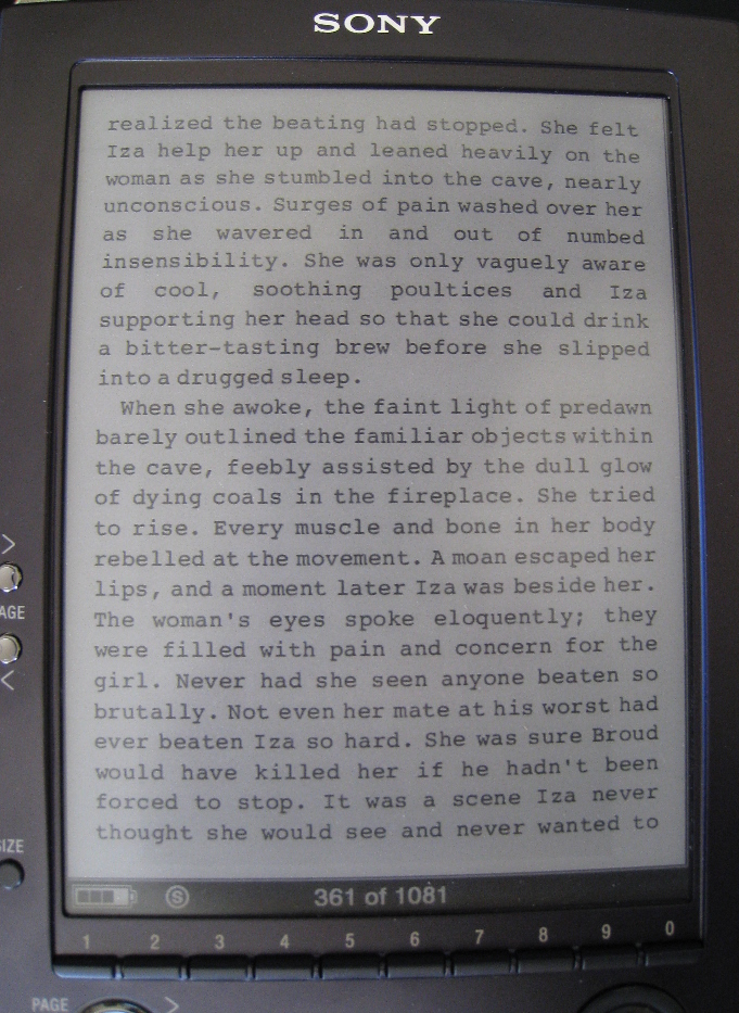

I've attached an image of the resulting lrf. The font looks like courier to me or at least a sarif font. I used with and without the dash:
body{ font-family: sans-serif}
p { font-family: sans-serif}
Thanks!

This looks like older version of calibre. Download and install latest version and report your findings.

OK, looks like it's working, but I ran into another issue. When calibre runs across Line Feeds in the .txt file, it switches the font back to that original one I was seeing. I have sans-serif until that point.
I guess I could just parse out those, but that's kind of a pain!
