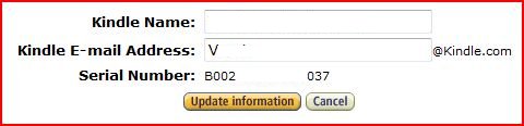

Should still work as the SN follows the same format as Kindle 1. I'm too lazy to try it now but I will try it and post my results.
B001 = Kindle 1
B002 = Kindle 2

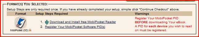

I have registered the new with BoB and downloaded another free copy of "The Nautal" by Abby Gains. I wasn't able to choose which PID should go with the book, so I'm not sure how this will turn out. Pre-checkout did state that a PID for *each* device must be registered.
I may not be able to complete this test until I have my K2.

Mobipocket books can include more than one PID - i.e. the same file can be read on more than one Mobipocket device.

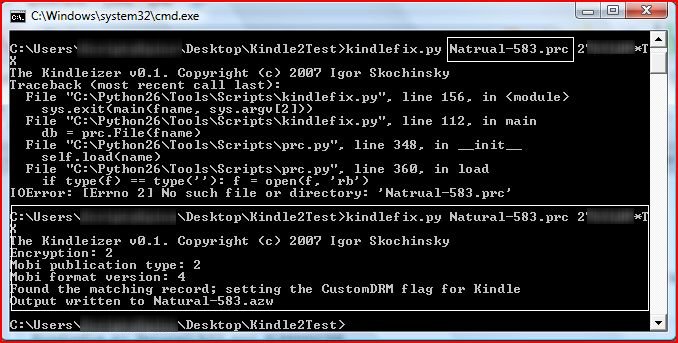

Okay, I just ran the script. At first I thought it didn't work until I realized I had a typo in the command (spelling very important).
The KindleFIX script does work with a K2 PID starting with a number. I'll check to see if the book ends up with the same EXTH title as a K1 book when I receive my K2.

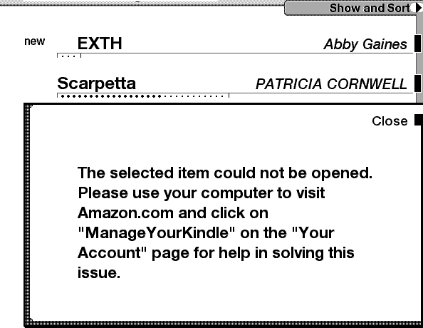

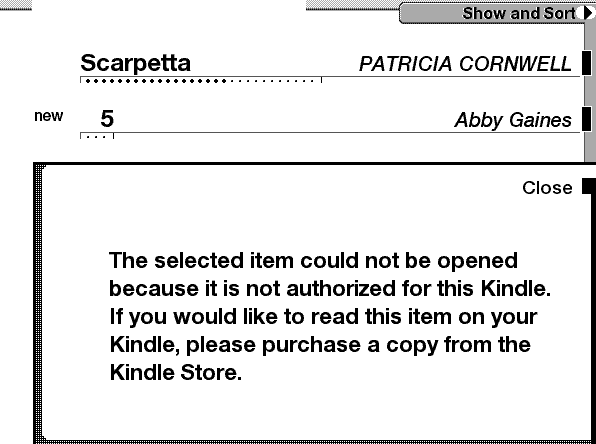

I just tried an experiment. I loaded the book KindleFIX'd with the K2 PID on my K1. The book showed with the title "5" and I was unable to open it (no surprise).
Image 1 (k2pidonk1)
I then ran the book through KindleFIX again with my K1 PID and loaded it on to my K1. It was titled with "EXTH" (no surprise) BUT, I could NOT open it (not good). I don't know why. The book may not have both PIDs encoded into it. I won't know for sure until I receive my K2.
Image 2 (k1pidonk1)

So, it may be, which I was thinking may be the case, that the kindle will only read a book encoded with 1 (its) PID... since that is how the Kindle books are encoded.
