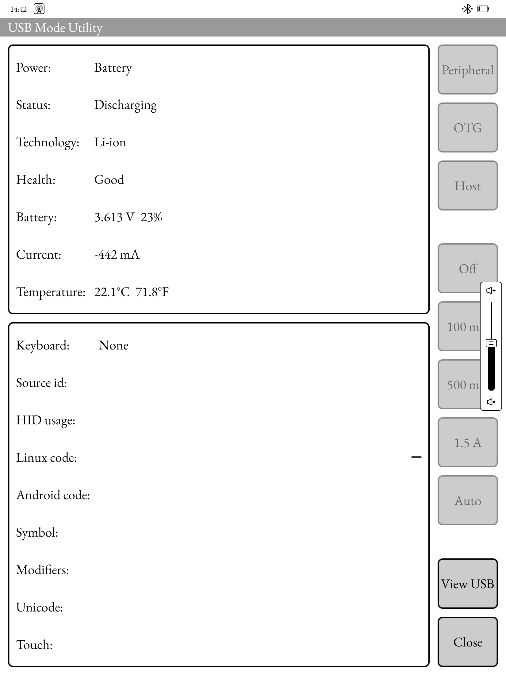

Well, if you have a BT headphone and it has buttons can you see the buttons in UsbMode.apk?
OTOH, they screwed around a lot with BT keys and they might be filtered already.

UsbMode is such an awesome app, but unfortunately I can't see the buttons.
(yes, I can see the touch events and USB keyboards)
