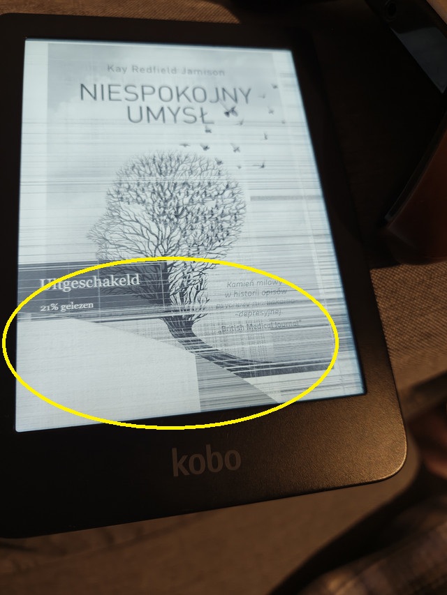

Hi everyone, I just found my old Kobo Clara HD after two years. The battery was completely dead, but the screen still showed the last book cover. When I powered it on, it only displayed artifacts. I suspected a bad SD card, so I tried InktBox and later the original image from DNSB on multiple cards, following the tutorial carefully, but no luck. Is there still hope for my Clara HD, or should I give up on it?

I would say your Clara HD is toast. Look at the curved line in the bottom part of the image attached below (inside the yellow ellipse). A classic example of a broken substrate.

Thanks. That’s unfortunate. I was hoping it would still work since the screen looked fine when I found it, and I thought the artifacts were just from corrupted software.
