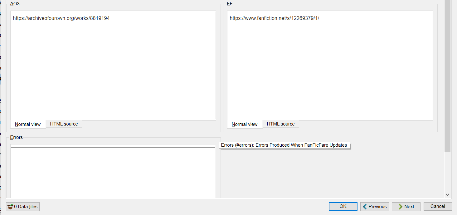

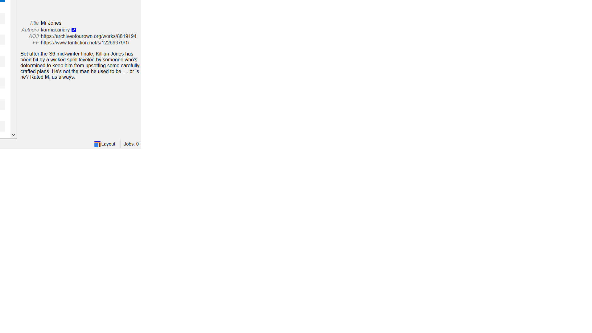

In discussing the links issue, I'm talking about the 'Books Detail' window in the main screen. I have it set to show title, author, two memo fields with links, and the comments field. Before any links in either the memo fields OR the comments field would show underlined in blue. Now they show like the attached image. Just plain text.
And, the memo fields don't show correctly in the editor. Another image is attached about that.
I'm on Windows 10. Calibre 8.12.0.

Okay I'm narrowing it down. It has to do with the color! I wiped out Calibre and reinstalled. Great! Link colors were back but Calibre installs with the dark color set so I changed everything to 'system' and my link colors went away.
So, I adjusted colors and got my links back. Yea!!
Also by wiping out and reinstalling Calibre, the edit window icons for memo fields are back again.
Thank you again for all of the help. I had originally assumed that I was missing a setting somewhere but it seems that things changed for link colors and something just got scrambled for the editor memo field icons.

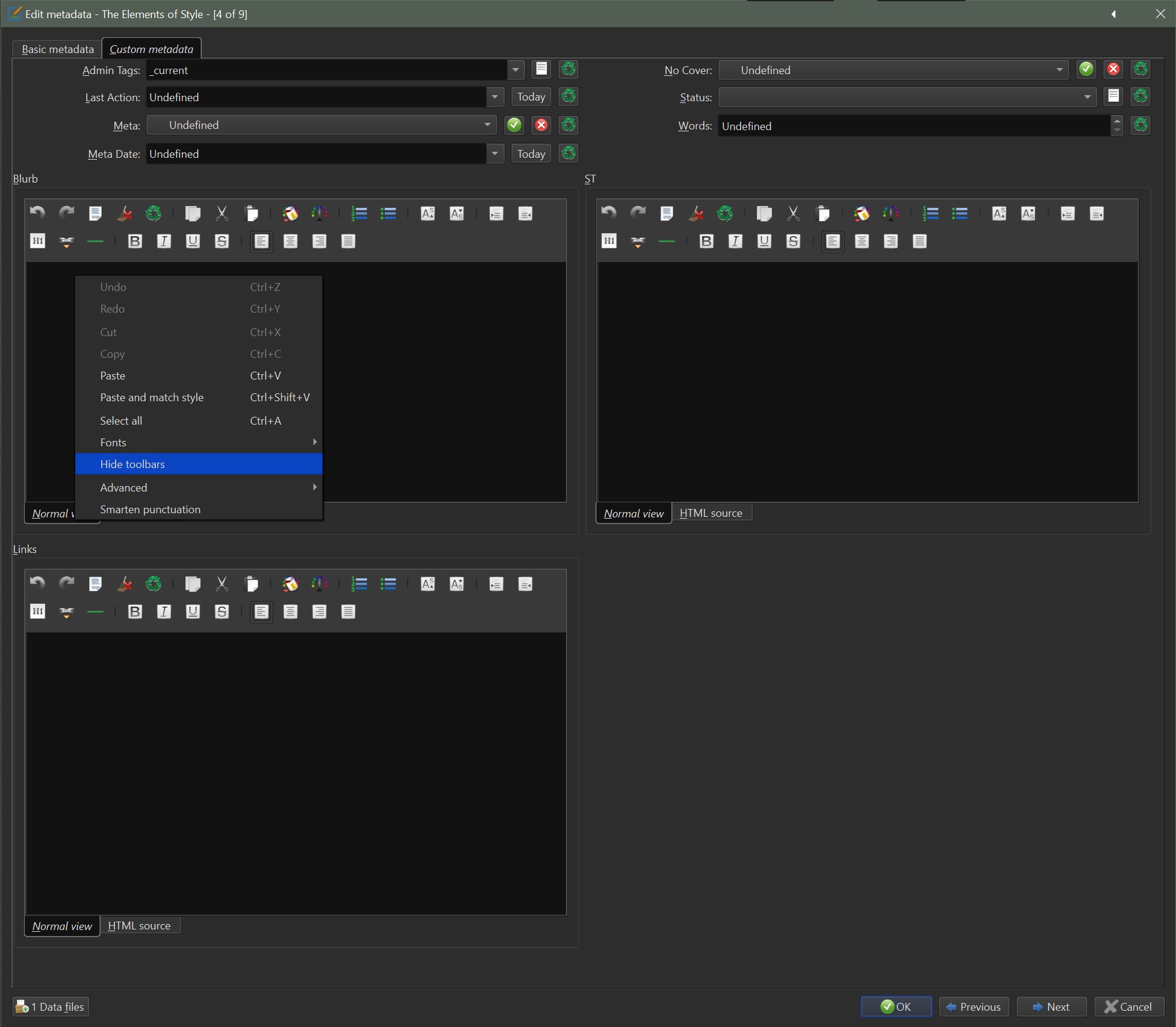

Looks like the toolbar icons in each of your 'memo' columns somehow got hidden, by default they're shown.
Name:	Screenshot 2025-10-09 120009.jpg
Added: if you change it from Show to Hide or vikky verca in one long text column (including comments) it changes all of them… maybe it should be in Look & Feel->Book Details… that's where I initially looked for it.
