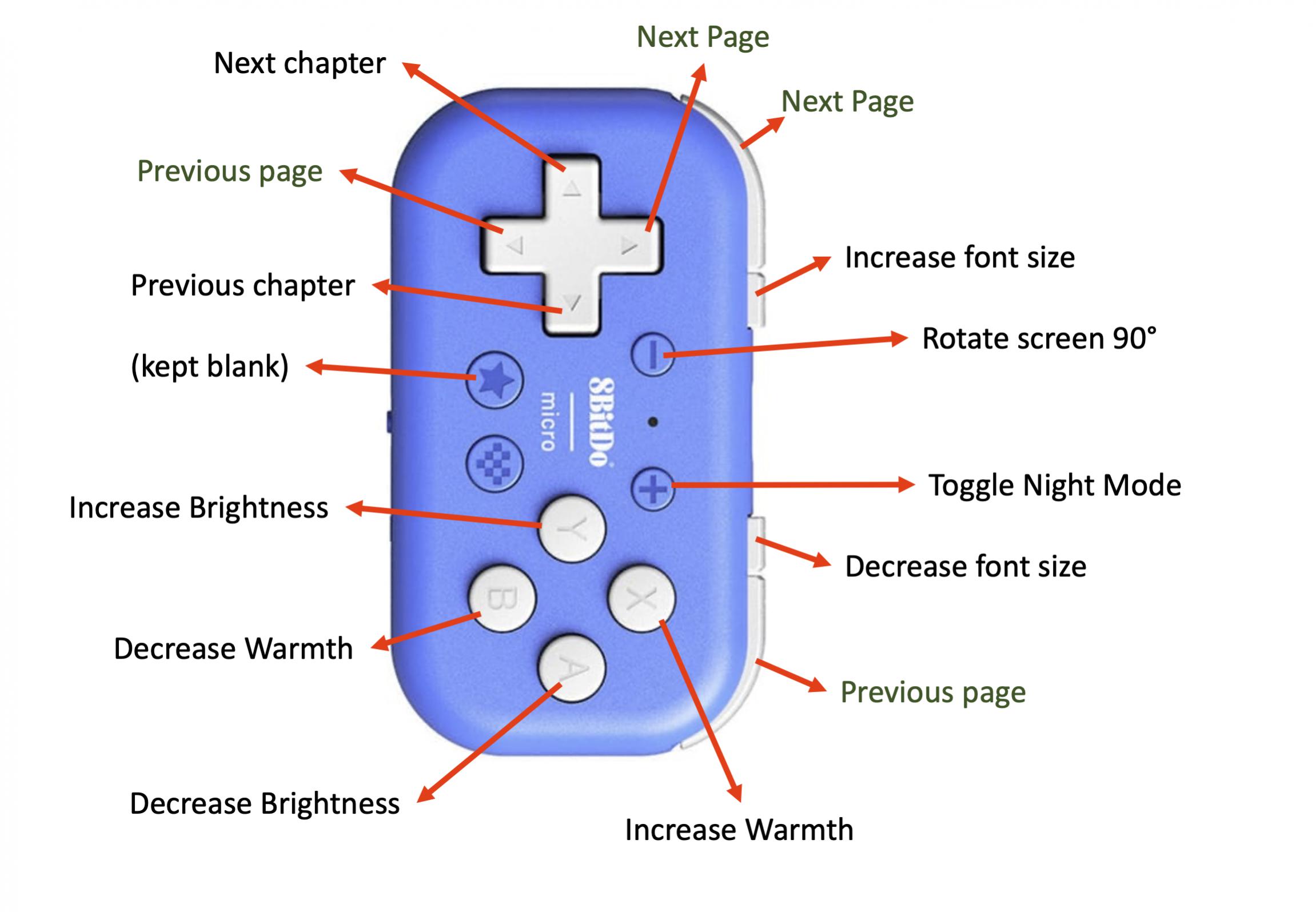

o Scroll up in the terminal window to see the long list of Event codes. Note that the text you get when you press any key is a very long list. Most of the list is not needed. You need to scroll back up to the top to see the event codes for your device. Now make note of whichever keys you mapped on your Bluetooth controller. For example, the line ‘Event code 20 (T)’ means that keyboard key ‘T’ has event code 20.
o In our case, the keys we mapped on the 8BitDo micro have event codes as follows –
Event code 103 (Up) — mapped to Left D-Pad
Event code 105 (Left) — mapped to Down D-Pad
Event code 106 (Right) — mapped to Up D-Pad
Event code 108 (Down) — mapped to Right D-Pad
Event code 104 (PageUp) — mapped to minus
Event code 109 (PageDown) — mapped to plus
Event code 21 (Y) — mapped to Y
Event code 45 (X) — mapped to X
Event code 48 (B) — mapped to B
Event code 30 (A) — mapped to A
Event code 38 (L) — mapped to Left Trigger L
Event code 22 (U) — mapped to L2
Event code 32 (D) — mapped to R2
Event code 19 (R) — mapped to Right Trigger R
Event code 24 (O) — mapped to Star button

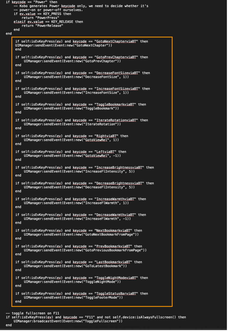

• The numbers in the brackets above are just random numbers I picked. They don’t have any significance here.
• Screenshot for reference --> see attachment Picture 2
• Scroll down further till you reach a function called Input:handleKeyBoardEv(ev). The following lines need to be within this function. I placed them just before a section with the header -- toggle fullscreen on F11.
if self:isEvKeyPress(ev) and keycode == "GotoNextChapterviaBT" then
UIManager:sendEvent(Event:new("GotoNextChapter"))
end
if self:isEvKeyPress(ev) and keycode == "GotoPrevChapterviaBT" then
UIManager:sendEvent(Event:new("GotoPrevChapter"))
end
if self:isEvKeyPress(ev) and keycode == "DecreaseFontSizeviaBT" then
UIManager:sendEvent(Event:new("DecreaseFontSize", 1))
end
if self:isEvKeyPress(ev) and keycode == "IncreaseFontSizeviaBT" then
UIManager:sendEvent(Event:new("IncreaseFontSize", 1))
end
if self:isEvKeyPress(ev) and keycode == "ToggleBookmarkviaBT" then
UIManager:sendEvent(Event:new("ToggleBookmark"))
end
if self:isEvKeyPress(ev) and keycode == "IterateRotationviaBT" then
UIManager:sendEvent(Event:new("IterateRotation"))
end
if self:isEvKeyPress(ev) and keycode == "RightviaBT" then
UIManager:sendEvent(Event:new("GotoViewRel", 1))
end
if self:isEvKeyPress(ev) and keycode == "LeftviaBT" then
UIManager:sendEvent(Event:new("GotoViewRel", -1))
end
if self:isEvKeyPress(ev) and keycode == "IncreaseBrightnessviaBT" then
UIManager:sendEvent(Event:new("IncreaseFlIntensity", 5))
end
if self:isEvKeyPress(ev) and keycode == "DecreaseBrightnessviaBT" then
UIManager:sendEvent(Event:new("DecreaseFlIntensity", 5))
end
if self:isEvKeyPress(ev) and keycode == "IncreaseWarmthviaBT" then
UIManager:sendEvent(Event:new("IncreaseFlWarmth", 1))
end
if self:isEvKeyPress(ev) and keycode == "DecreaseWarmthviaBT" then
UIManager:sendEvent(Event:new("IncreaseFlWarmth", -1))
end
if self:isEvKeyPress(ev) and keycode == "NextBookmarkviaBT" then
UIManager:sendEvent(Event:new("GotoNextBookmarkFromPage"))
end
if self:isEvKeyPress(ev) and keycode == "PrevBookmarkviaBT" then
UIManager:sendEvent(Event:new("GotoPreviousBookmarkFromPage"))
end
if self:isEvKeyPress(ev) and keycode == "LastBookmarkviaBT" then
UIManager:sendEvent(Event:new("GoToLatestBookmark"))
end
if self:isEvKeyPress(ev) and keycode == "ToggleNightModeviaBT" then
UIManager:sendEvent(Event:new("ToggleNightMode"))
end
if self:isEvKeyPress(ev) and keycode == "ToggleStatusBarviaBT" then
UIManager:sendEvent(Event:new("ToggleFooterMode"))
end

• The final key mapping used in these instructions is shown in the Picture 6 attachment.

• IMPORTANT NOTE: Currently there is a known bug in KOReader where exiting KOReader while Bluetooth is ON, reboots the device and often removes NickelMenu. You then have to transfer the KoboRoot.tgz file into the .kobo folder again to get NickelMenu back. This behavior can be avoided by choosing ‘Reboot the device’ in the exit menu, instead of ‘Exit’. So, while this issue exists, remember to reboot the device to exit KOReader while you have Bluetooth ON • These instructions do not use any plug-in or different Bluetooth drivers. The default Kobo Bluetooth drivers work just fine.
Features enabled:
• This guide will enable the following features via Bluetooth -
o Go to next page / previous page
o Go to next chapter / previous chapter
o Increase Font size / Decrease Font size
o Increase brightness / Decrease brightness
o Increase warmth / Decrease warmth
o Go to next bookmark / previous bookmark
o Rotate screen
o Toggle Night mode
o Toggle Bookmark
o Toggle Status Bar
• I’ve not mapped every single of the above features to my controller, but this guide will show you how to map whichever features you want.
Step 1 – Set up your Bluetooth controller
• Skip this step if you are not using a controller that allows for custom mapping. Since I use the 8BitDo micro, I’ve included mapping for that device.
• I’ve set up mapping assuming controller usage in vertical orientation, but you may set it up any which way you like.
• 8BitDo micro will be used in keyboard mode. Go ahead and map random keyboard keys to all the buttons using the 8BitDo Ultimate Software. It does not matter which keyboard keys you map here. We will be noting down codes for all those keys later. For reference, this is how I’ve mapped my controller --> (See attached Picture 1)
• Note that I’ve mapped the ‘Keyboard right key’ to the Up D-Pad, and ‘Keyboard left key’ to the Down D-pad. This is on purpose since keyboard left and right arrow keys turn pages on the native Kobo reader without any additional setup. And since I hold the micro vertically, mapping it this way is more intuitive to me.

Step 4 – Update input.lua file
• Connect your ereader to you computer via USB
• Navigate to KOBOeReader/.adds/koreader/frontend/device
• Take a backup of the input.lua file, so you can place the original back and start over if anything goes wrong.
• Open input.lua
• Scroll down to the section which has the header – set up fake event map (This section has lines that look like Self.event_map[10000] = “IntoSS”)
• Add the following lines to this section –
self.event_map[20000] = "GotoNextChapterviaBT"
self.event_map[20001] = "GotoPrevChapterviaBT"
self.event_map[20002] = "DecreaseFontSizeviaBT"
self.event_map[20003] = "IncreaseFontSizeviaBT"
self.event_map[20004] = "ToggleBookmarkviaBT"
self.event_map[20005] = "IterateRotationviaBT"
self.event_map[20007] = "RightviaBT"
self.event_map[20008] = "LeftviaBT"
self.event_map[20009] = "IncreaseBrightnessviaBT"
self.event_map[20010] = "DecreaseBrightnessviaBT"
self.event_map[20011] = "IncreaseWarmthviaBT"
self.event_map[20012] = "DecreaseWarmthviaBT"
self.event_map[20013] = "NextBookmarkviaBT"
self.event_map[20014] = "PrevBookmarkviaBT"
self.event_map[20015] = "LastBookmarkviaBT"
self.event_map[20016] = "ToggleNightModeviaBT"
self.event_map[20017] = "ToggleStatusBarviaBT"
end
end
end
end
end
end
end
end
end
end
end
end
end
end
end
end
end
• Screenshot for reference --> see attachment Picture 3

[105] = "LeftviaBT", -- You can also use "RPgBack" on Libra Colour
[106] = "RightviaBT", -- You can also use "RPgFwd" on Libra Colour
[103] = "GotoNextChapterviaBT", -- D-pad left (Up when held vertically)
[108] = "GotoPrevChapterviaBT", -- D-pad right (Down when held vertically)
[21] = "IncreaseBrightnessviaBT", -- Y-button
[30] = "DecreaseBrightnessviaBT", -- A-button
[45] = "IncreaseWarmthviaBT", -- X-button
[48] = "DecreaseWarmthviaBT", -- B-button
[22] = "IncreaseFontSizeviaBT", -- L2 button
[32] = "DecreaseFontSizeviaBT", -- R2 button
[104] = "IterateRotationviaBT", -- Minus button
[109] = "ToggleNightModeviaBT", -- Plus button
[38] = "RightviaBT", -- Left Trigger L
[19] = "LeftviaBT", -- Right Trigger R
• Screenshot for reference --> see attachment Picture 4
