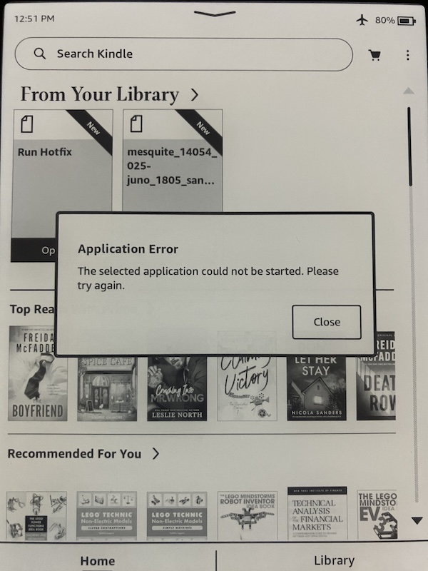

Unfortunately this is not working for me. I get all the popups including the "Bang!" popup, but after I install the hotfix and it reboots, the hotfix won't run. Instead I get this error message:
"The selected application could not be started. Please try again."
This is a 2024 Kindle Paperwhite running 5.18.5, and I tried reflashing the firmware and doing a factory reset with the same results.
Any ideas?
Thanks!
Any ideas?
Thanks!
Apparently I can't edit my post, but I also wanted to add that there is no update.bin.tmp.partial or .bin file etc when I install the hotfix. And it's in Airplane mode.
Does the hotfix need to be updated for 15.8.5 maybe?
