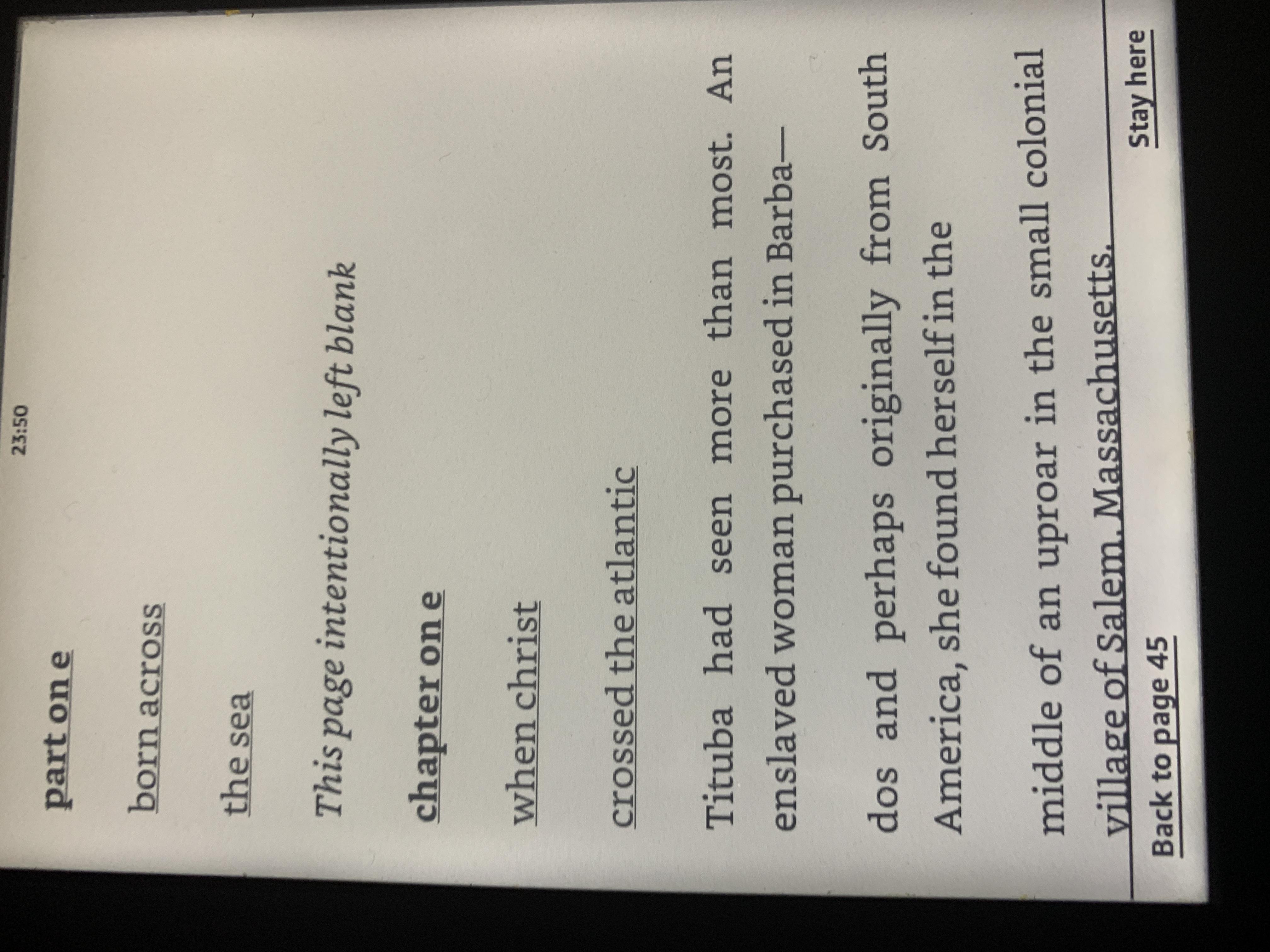

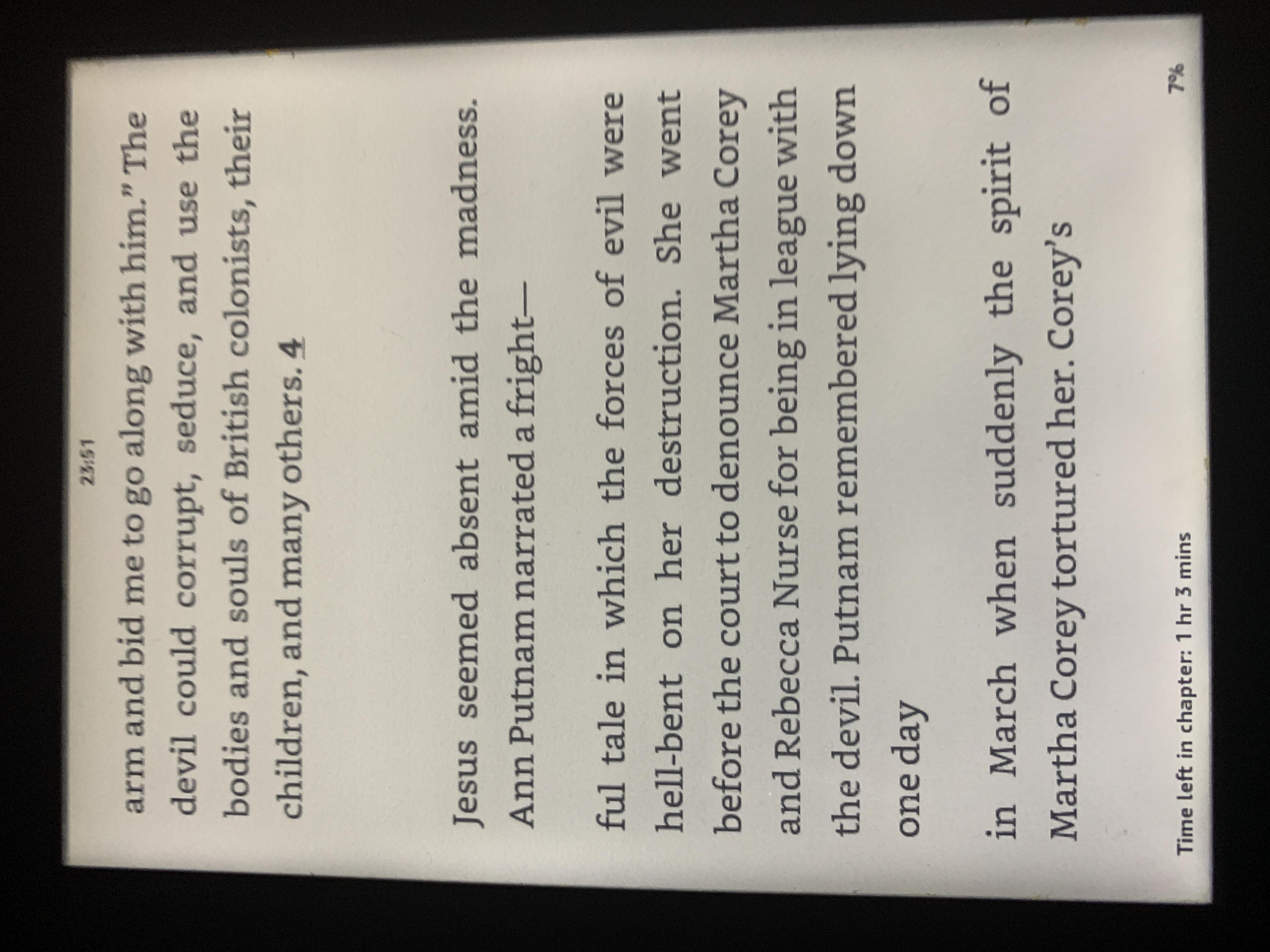

I have an annoying problem that even after converting books in Calibre editor, some are riddled with random line breaks. Can someone advise me on how to fix without having to manually go through the HTML editor. Is there a code/regex/plug in. TIA. Apologies if this should be on another thread.

It looks like it could be a rather poor conversion from a PDF source.
You could use regex to combine lines that do not end in a punctuation mark. That would help a lot.
Read this thread, It gives a lot of good information including link(s) to regex to use. https://www.mobileread.com/forums/sh...d.php?t=357635

A crappy conversion from PDF will always be a crappy conversion, unless you fix everything by hand, line by line. PDF is not a suitable format for conversion.
TL;DR Don't convert from PDF if you can do it in any other way.

If it's a bad PDF conversion (and it almost certainly is, by the looks of it), there's no fixing it.

Trying to fix via conversions, yea totally agree. Can't be done.
If you are prepared to read and fix at the same time, it can be done. Even easier if the original book is available as a reference.
A few regex to catch the split sentences are easy enough. It's all the other annoying missing italic, replaced characters, broken words and spurious code that are more difficult/impossible to bulk fix.

It's almost certainly a low quality OCR image scan of ink on paper (probably with an ancient version of ABBYY - probably pirated), that was saved as a PDF.
Professionally created PDFs using Acrobat, DTP (InDesign, even Quark), or WP (MS Word, LO Writer, WordPerfect) don't break paragraphs like that.
One way to deal with it, is to convert to txt, open with a decent text editor (e.g. Vim, Text Pad, Notepad++) and correct using regex. Then open the corrected text file in one of the WP apps mentioned above, style front-matter, headings, bibliography etc as appropriate and save as DOCX and get calibre to convert that to EPUB.
If you use Wordperfect you can save as EPUB directly, which does a better job of mapping its styling to the EPUB CCS.
There are also useful addins for Word - EPUB Tools (it is in the MR Workshop forum), and Transtools, which has an excellent Unbreaker tool.

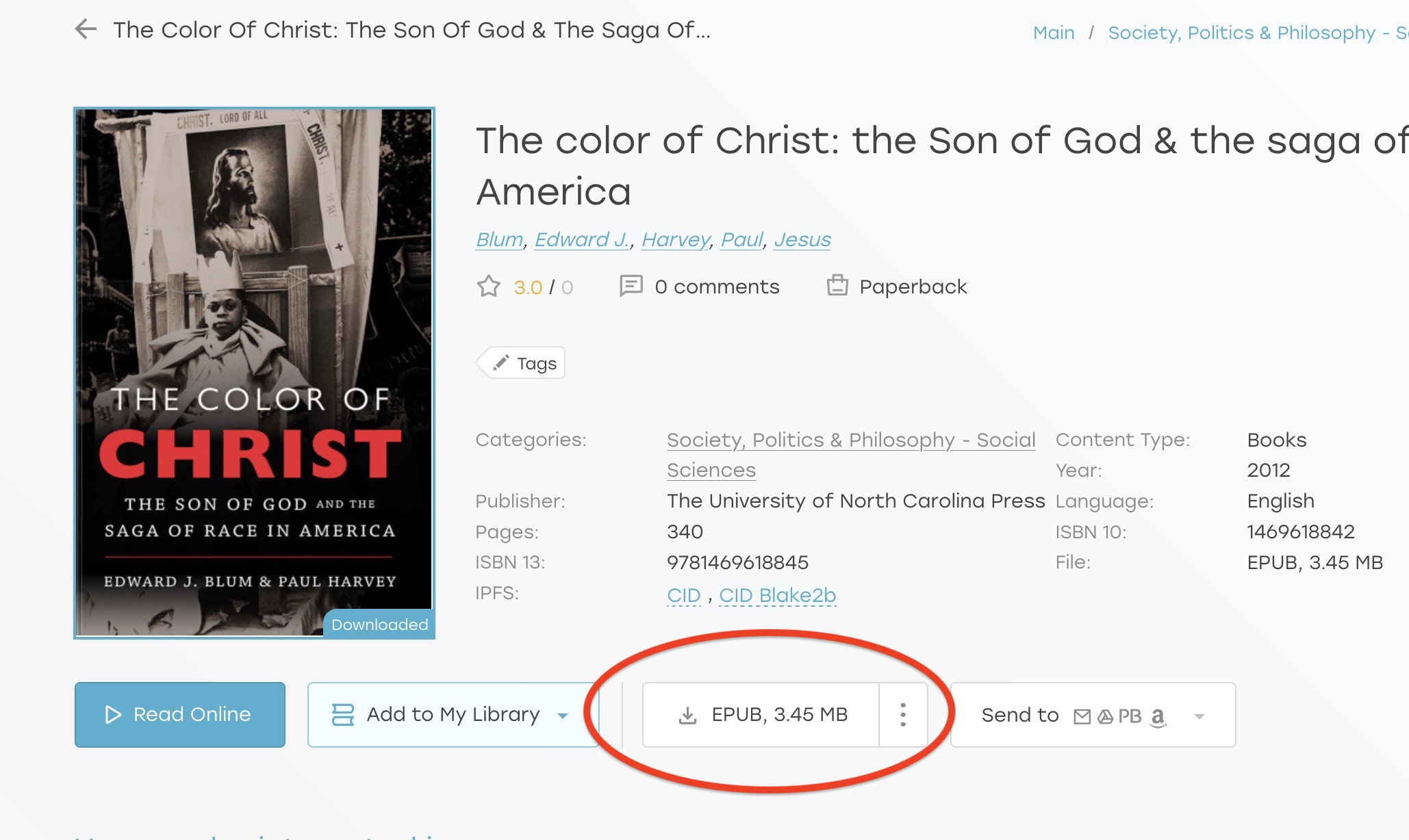

It's definitely EPUB which was downloaded from Z-Library. Screenshot attached.

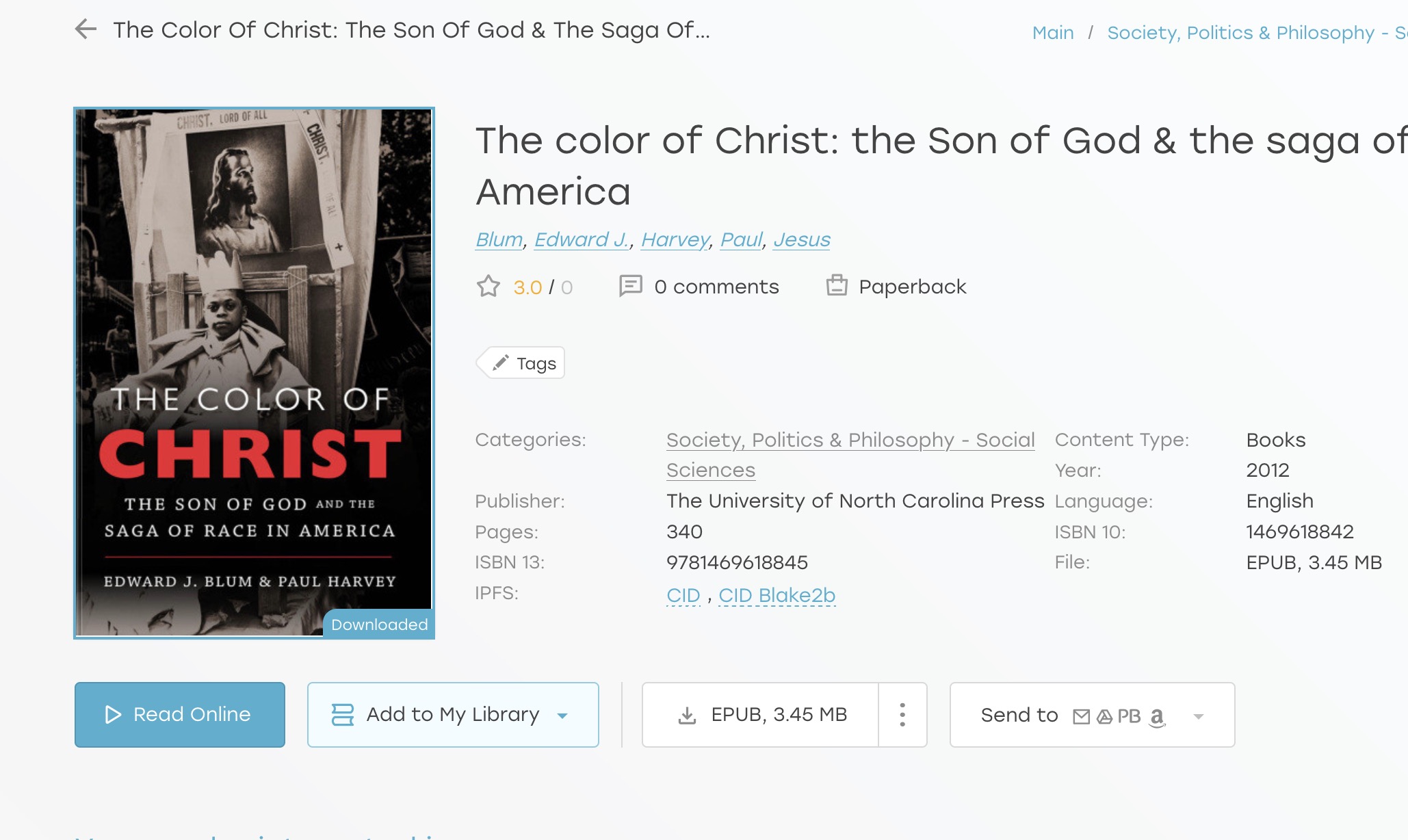

Definitely and EPUB download into calibre

That the screenshots posted by the OP were from a PDF to ePub conversion seems an inescapable conclusion. Since the source mentioned by the OP in a later message was Z-Library, a rather well known pirate site, I'm out of this discussion.
