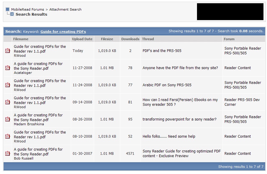

Here is a copy of the Sony provided guide to making PDFs for the Reader. It is posted elsewhere at MobileRead, I just can not find it at the moment to create a link for you.
File Type: pdf Guide for creating PDFs for the Reader rev 1.1.pdf (1,019.0 KB, 422 views)
Old 02-02-2009, 11:46 PM   #9
nrapallo
GuteBook/Mobi2IMP Creator
nrapallo's Avatar
Posts: 2,958
Karma: 2530691
Location: Toronto, Canada
That's a popular attachment. It helps when you know the exact filename...
For version 1.1, try:
https://www.mobileread.com/forums/sho...137#post232137
https://www.mobileread.com/forums/sho...598#post252598
https://www.mobileread.com/forums/sho...718#post295718
