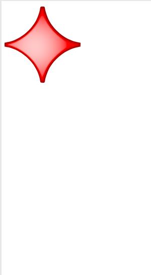

No, no plugin is needed; you should see something like:

Post a screenshot of your output; there must be some kind of bug with your system, because when you open the epub I attached, as I said in a previous post, you should see something like:
The original svg file (image1.svg) is a plain grayscale image (full filled with color="#777"). The final color, the brushed metal effect and 3D appearance are product of the applied filter.

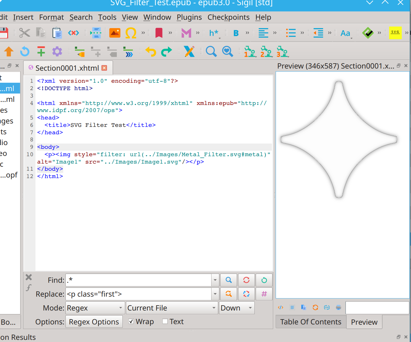

The same role of any of the css filter. But svg filters are more powerfull than the css ones.
Yes, that's right.
Attachment 217826
Thanks for the reply, RbnJrg.
Your attached image is the first time I've seen any red color.
I find it hard to believe I've a system problem because I've tried on my MacBook, Linux and W11 machines and I always get a greyscale image whether I select the .xhtml file or the image file. I'm using Sigil 2.6.0 with Qt 6.8.2 on all 3 machines.
That's why I wondered if there is a plugin needed to correctly view the SVG image.
Attached is a screenshot from my linux machine showing Preview of the file Section0001.xhtml

For what it may be worth, I see what @philja is reporting. If I remove the url from the link to the filter, it shows a solid colour in Preview.

I have a potential fix, but I am in the same boat as DNSB and philja. I do not see any color at all (before or after the change from red to blue).
So I can not even test my fix!
So something is funny.
