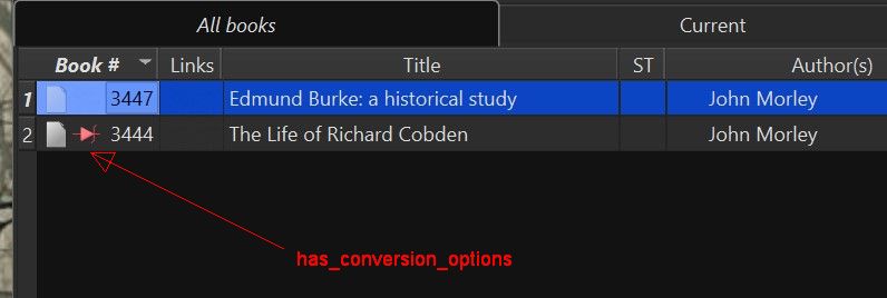

Maybe chaley could add a 'has_conv_settings' template function - a'la his 'has_extra_files' function. I currently show a diode.png if #admin_tags has conv-set, which I could change to has_conv_settings().

Here is a python stored template that does the job. It is in a form suitable for import in the Stored Templates tab in Preferences / Template functions.
- works a treat of course.

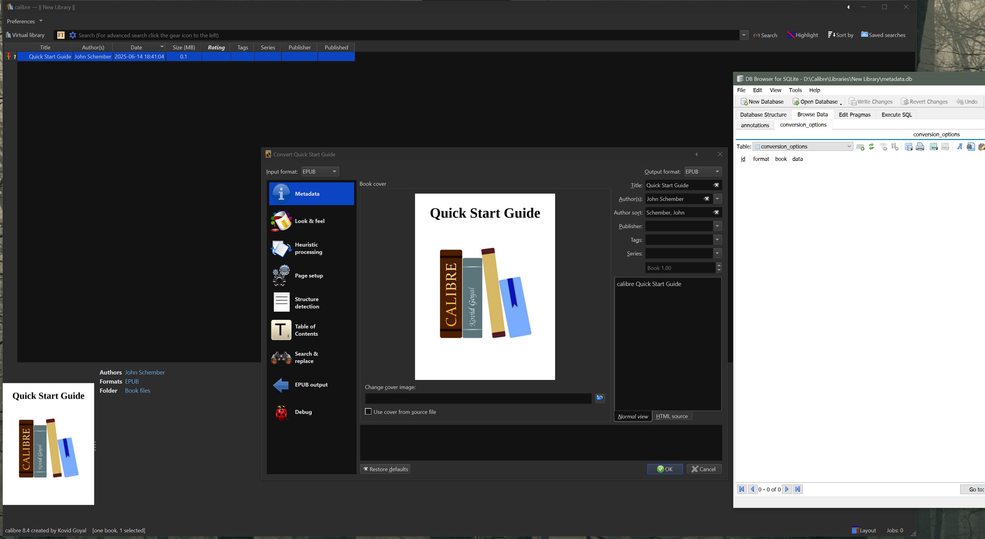

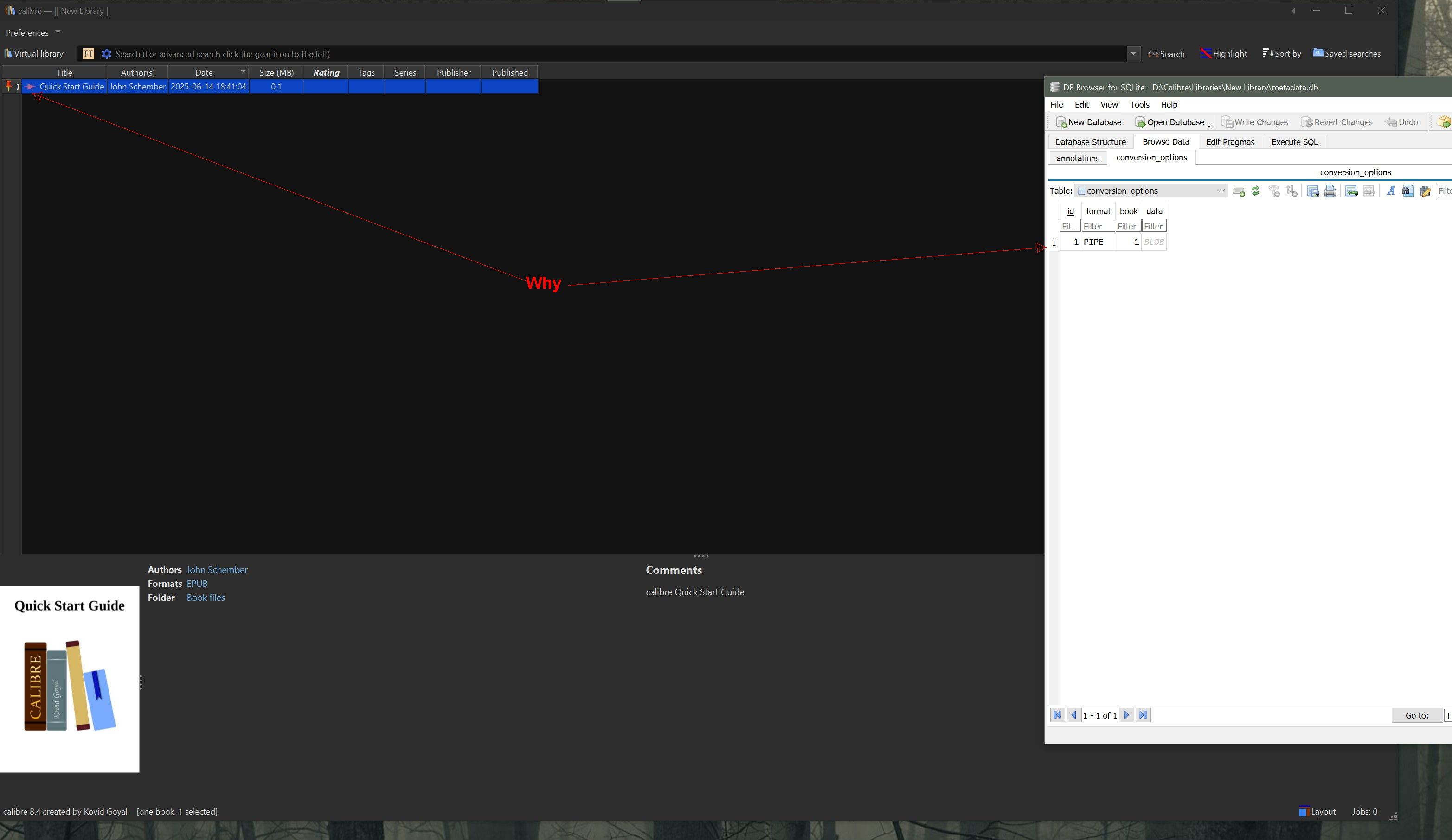

Huh - I get a row added to conversion-option table for every conversion I do.
I created a new library and added the Quick Start guide. I added the Stored Template chaley provided above, and use that template in a column icon rule.
I then did an EPUB->EPUB conversion with no adjustments to any of the Transform settings. After the conversion the "has_conversion_options" icon is shown AND a row has been added to the conversion options table - see attached before and after screenshots.
That seems contrary to what's written here ==>> How options are set/saved for conversion
ID:	216219   Click image for larger version

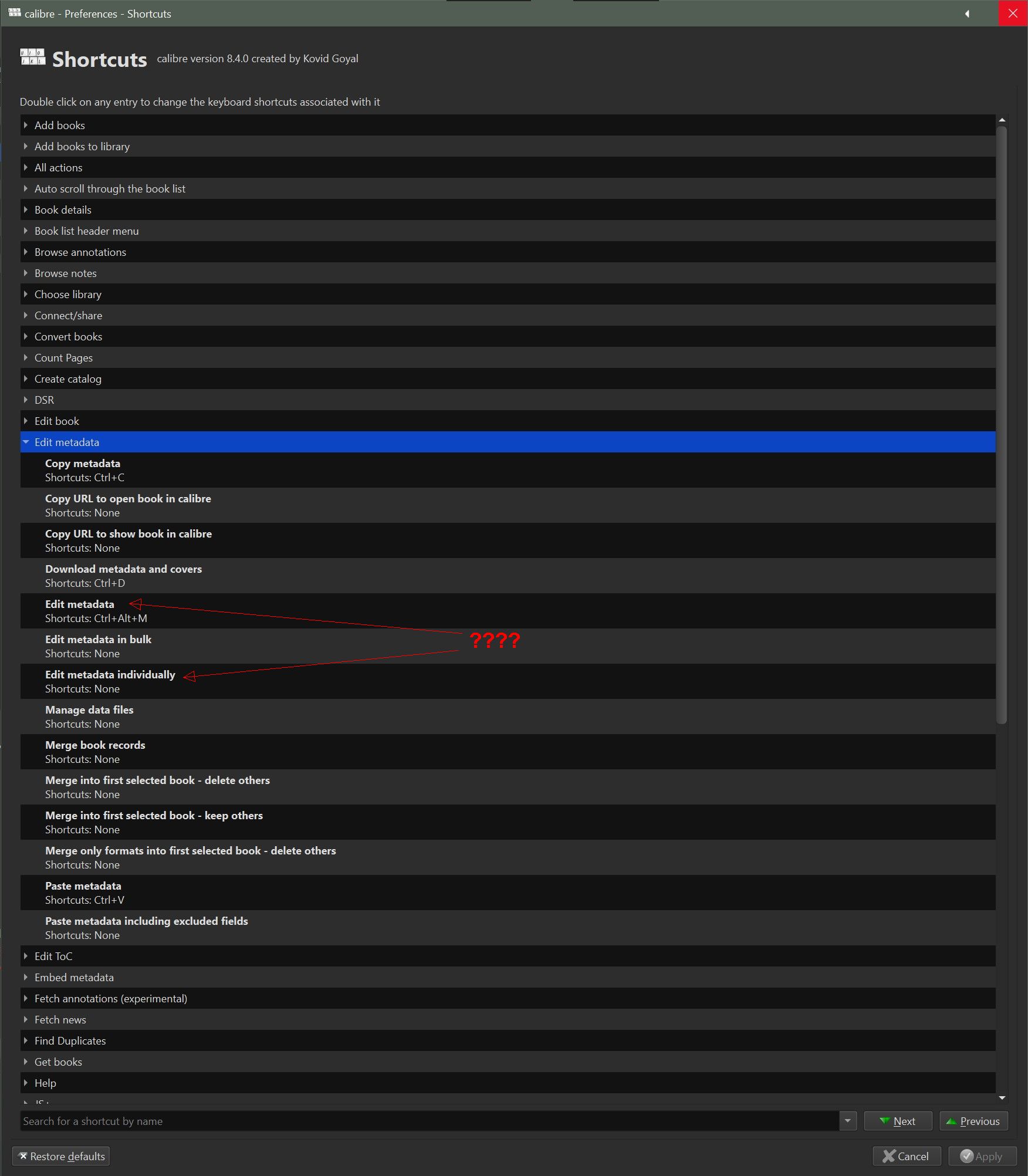

What is the difference between these two shortcuts, Edit metadata->Edit metadata AND Edit metadata->Edit metadata individually
Old 06-14-2025, 08:33 PM   #10
Posts: 46,530
Karma: 29634066
The first will show you single or bulk dialogs depeneding on the number fo books selected automatically.
Old 06-15-2025, 06:26 AM   #11
chaley
Posts: 12,529
Karma: 8125420
Location: Notts, England
The Edit Metadata shortcut will start Edit Metadata (Single) if one book is selected, otherwise Edit Metadata (bulk). The Edit Metadata individually shortcut will always start the Edit Metadata (Single) dialog no matter how many books are selected. You use "next" and "previous" to move through the selected books.
