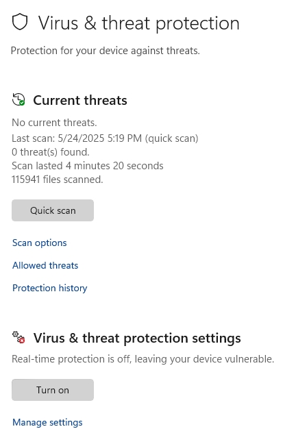

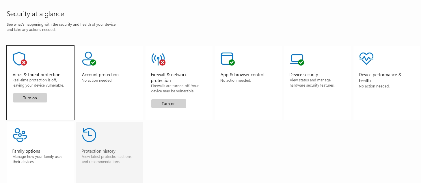

I had tried it in windows safe mode, and I doubly checked to make sure even windows security and defender were set to off.

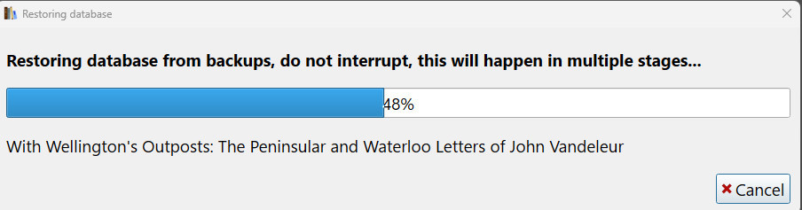

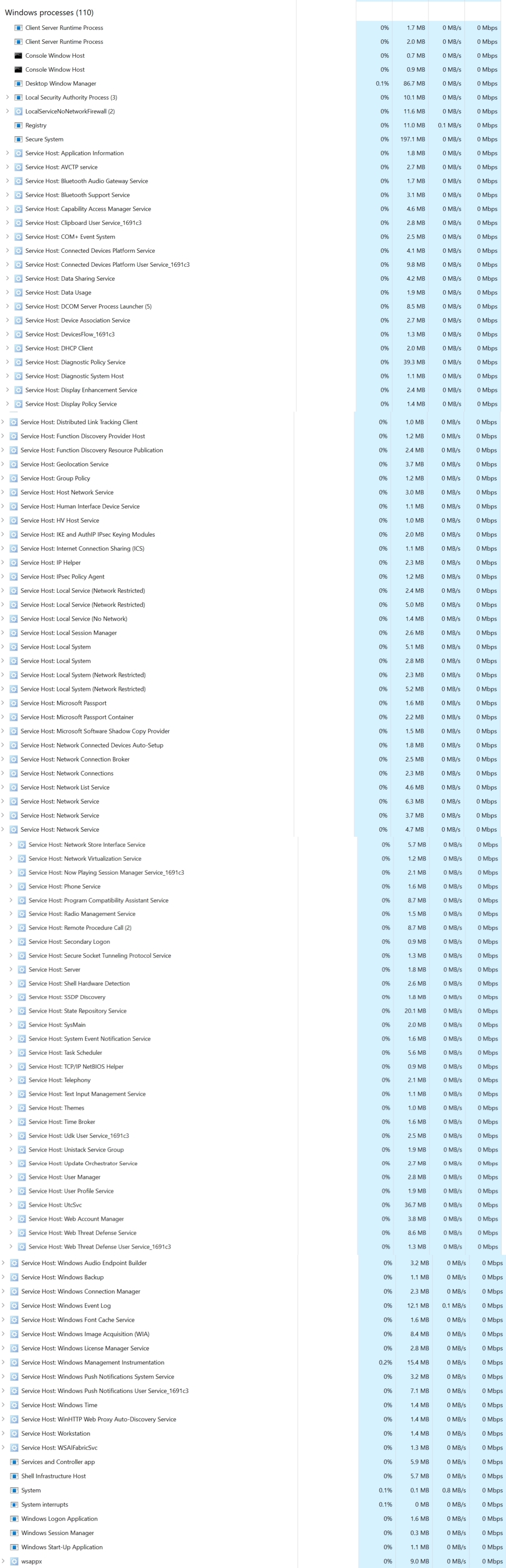

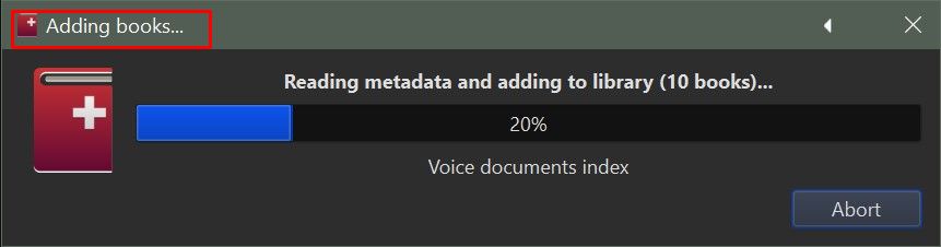

I did, and after over 12 hrs or so it showed it as done. So I added another book and it immediately crashed and gave me more of those errors.
I did both of the delete metadata and restore, and then I tried the starting from a blank and add books from the old folder.
With the delete metadata and restore, I still get crashes. With the add books it added only 900 of the 27k and then crashed.

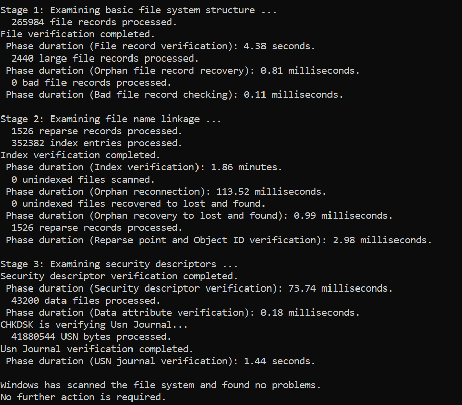

I also checked both hard drives (internal C and D) for errors (chkdsk and windows error checking) and defrag and found no problems. Even downloaded a hard drive S.M.A.R.T program and it found no issues with either drive.
see attachment
But it's still crashing constantly and I can't figure it out.
The first screen shot you posted is from the Restore database feature, if you add books from an existing library folder, as per the link to Kovid's recommendation in my previous post, you will see something like this:
Attachment 215817
Yeah I tried that and it got to 900 books and then just crashed out. No screen shot because it was going good and then... was gone!

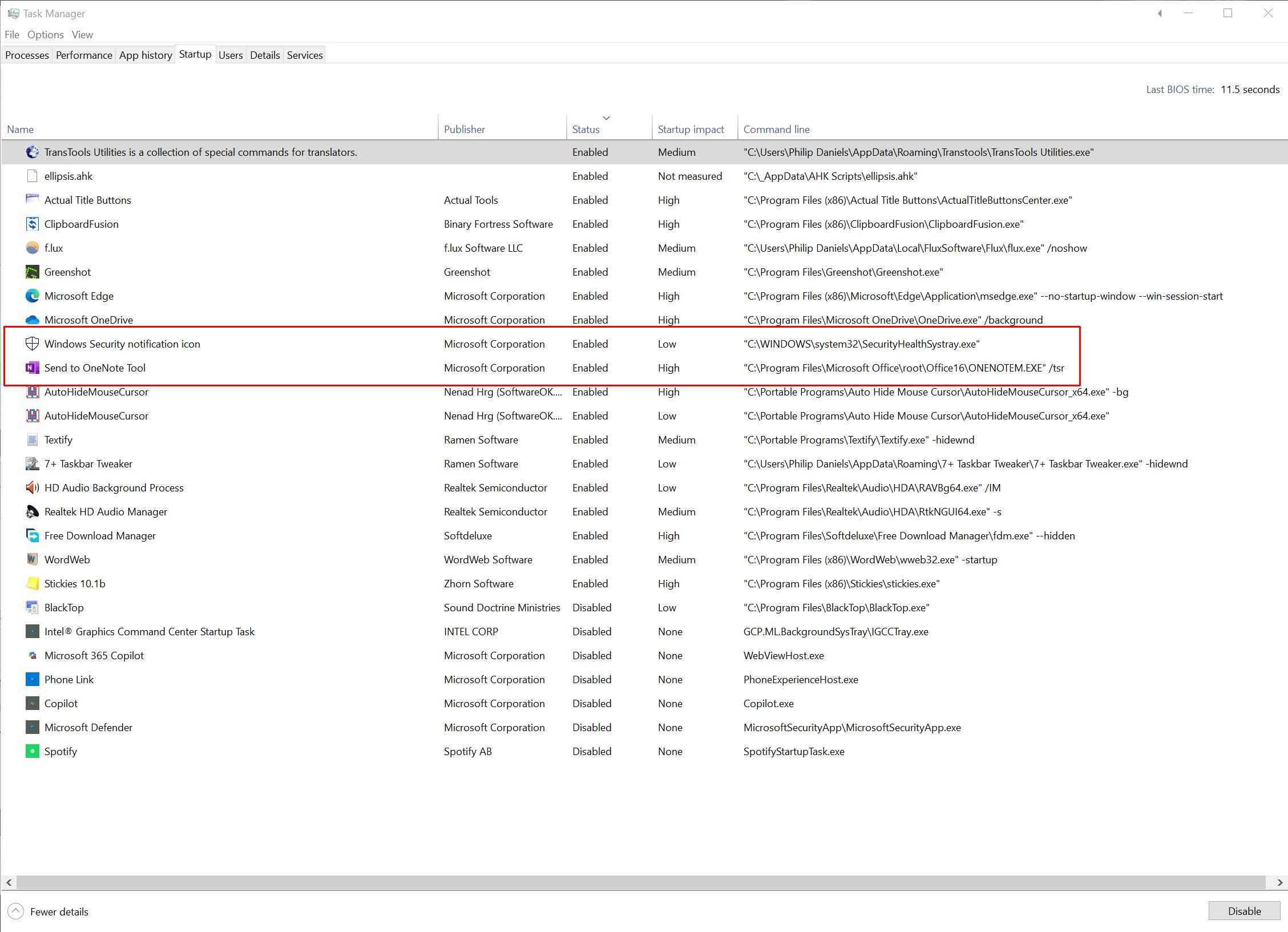

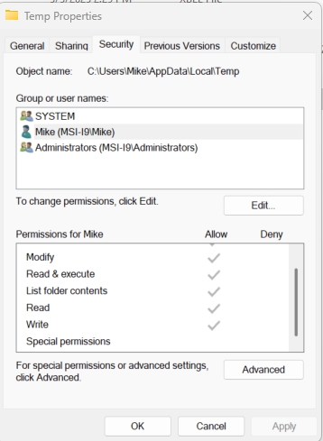

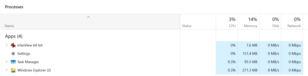

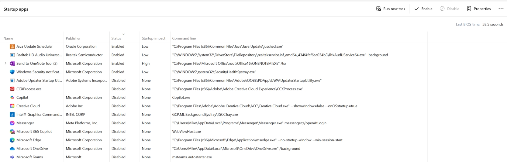

Thanks! I went through that list, and I'm still pretty flumoxed because there really isn't much installed on this system at all.
As you can see the startup that is enabled is pretty limited, and the stuff that's disabled below are things like Copilot, Xbox, and Teams.
Under Processes, you can see there's not a lot running under background that isn't standard windows, and same with the processes.
But you're right, logically something is running in main mode that isn't in safe mode, and all I can think of is the NVIDIA drivers or Adobe Creative Cloud, but that makes no sense at all.
I even checked on the permissions of everything, and all seems good, like the temp file mentioned at that link.
Only other thing mentioned was to try the 32 bit version, but I didn't find one and I've got a feeling that there isn't one anymore.

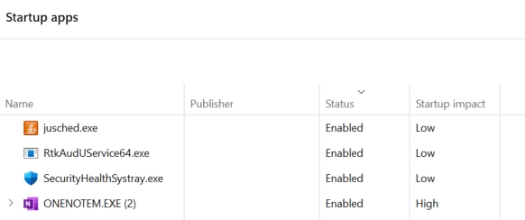

What version of Windows is that, on up-to-date Win10 I see the description the file in the Name column of Task Manager, not the executable name - see attachment.
Hey there, it's Win 11 10.0.26100 Build 26100
Processor Intel(R) Core(TM) i9-14900KF, 3200 Mhz, 24 Core(s), 32 Logical Processor(s)
Installed Physical Memory (RAM) 64.0 GB
I added the other column so you can see what is enabled and disabled.

I'm not. I have 2 internal drives, a C drive which is a speedy SSD, and a D drive which is an HDD. I've tried installing the program on C and database on D, both on D, and both on C with the same issues.
As for AV, I turned off windows defender and only manually ran it the other night just to make sure the system was clean.
Thanks for the help!!!
