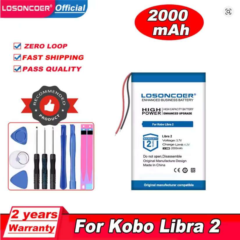

You could probably open the Sage and replace the battery with a better battery. I've seen it doe for the Libra 2. I read a post on redddit where someone replaced a Libra 2 battery with this one. And I did ask and it's working well.
You can't without cutting away ribs on the cast alloy chassis. I did explain this earlier.
It is simply the size, not the quality.

I did help one friend replace the battery in their Sage with a 1500mAH unit that was the same size. If they can keep from plugging their Sage in every time they read 15 minutes, perhaps this battery will live longer. After a couple of calibration cycles, it does give them about 20% longer reading time before the battery gauge drops to 10%.
