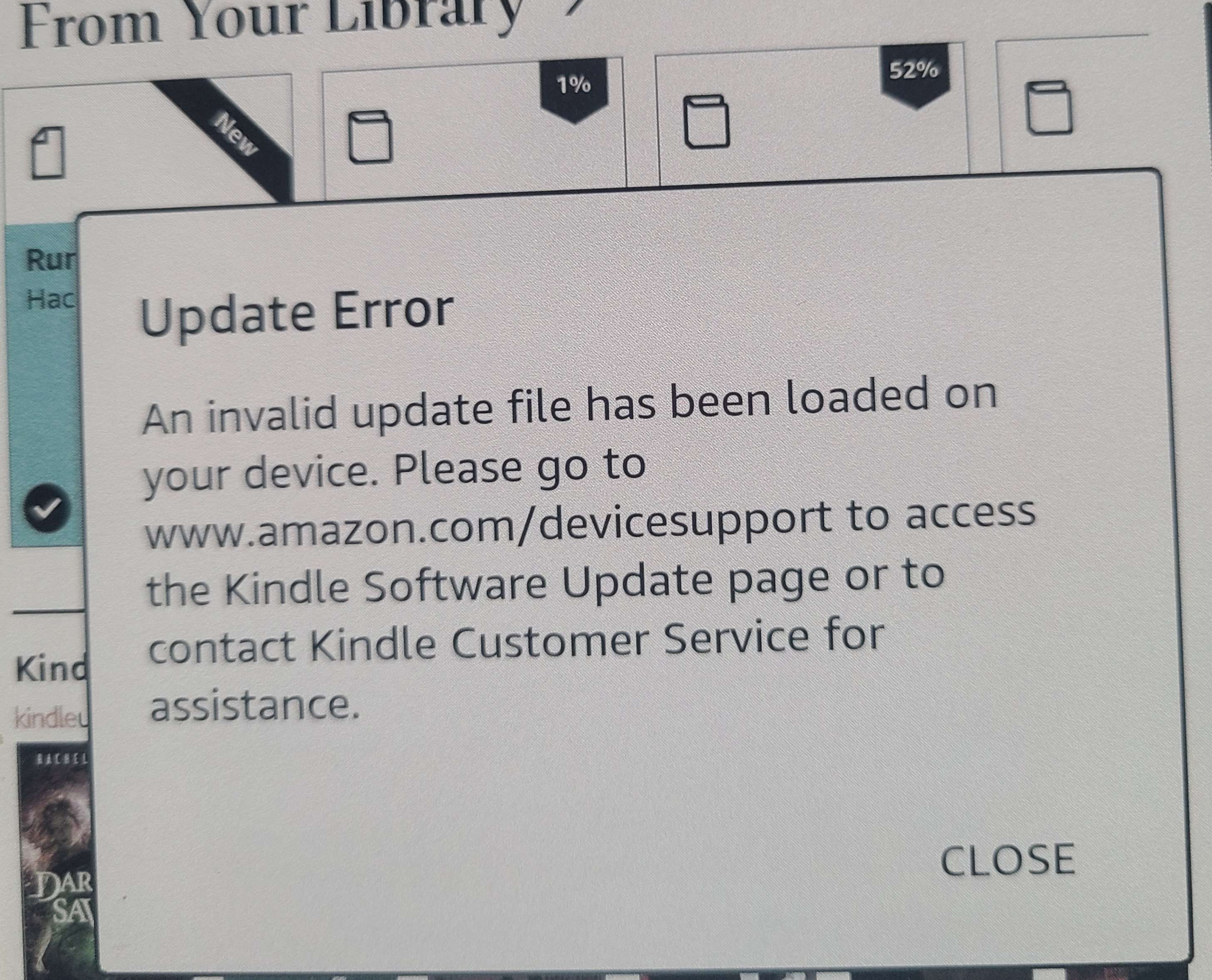

Hi, I am trying to install KUAL on my Colorsoft but am having no luck. When I run ;log mrpi I get a white screen and then after a bit it goes back to home page but no KUAL.
I tried the hotfix via update method but no luck

That screen suggests that your Colorsoft has not been jailbroken.
And could you please remove that oversized image. Go to advanced mode and use the Paperclip icon or Manage Attachments button so we see a thumbnail that can be clicked on to display the full size image.

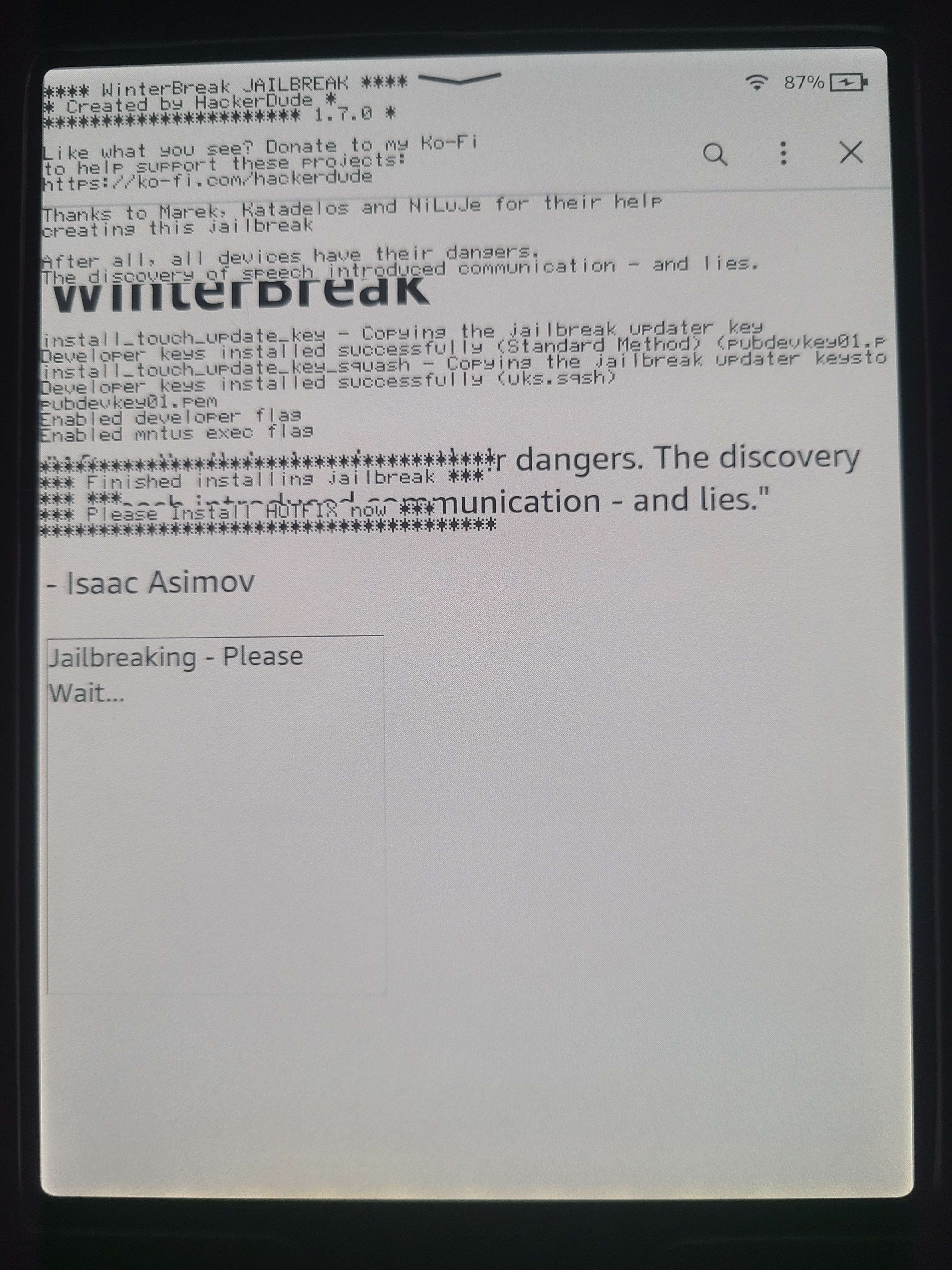

I redid the jailbreak, same results
