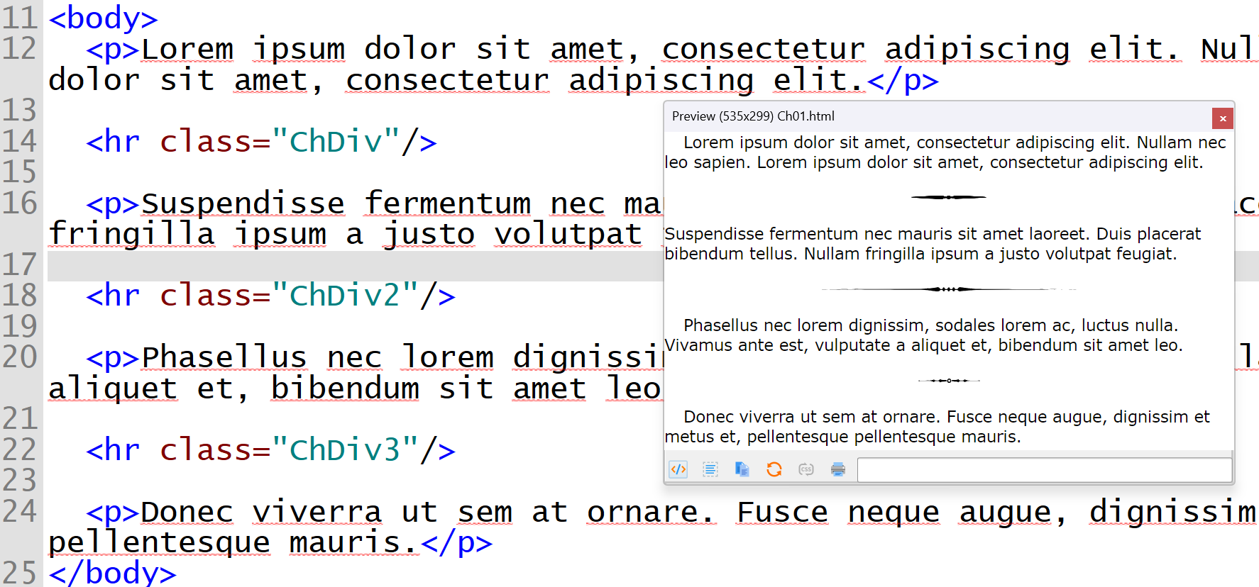

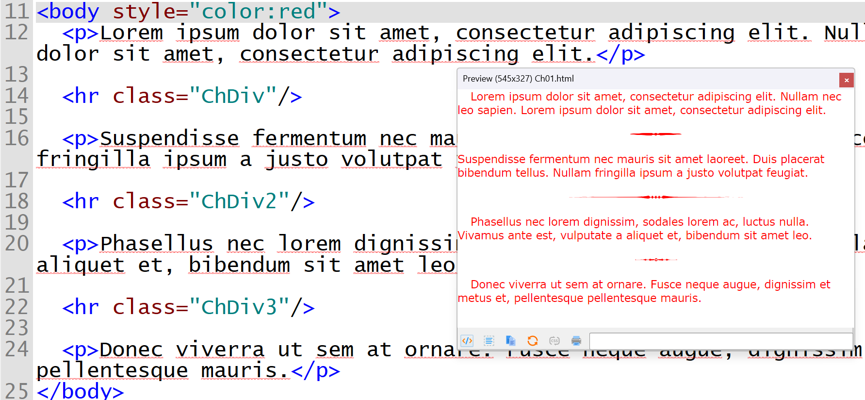

Here are a few screenshot examples:
Name:	Screenshot 2024-12-05 113830.png
ID:	212356 Click image for larger version
Name:	Screenshot 2024-12-05 113906.png
ID:	212357 Click image for larger version
Name:	Screenshot 2024-12-05 113944.png

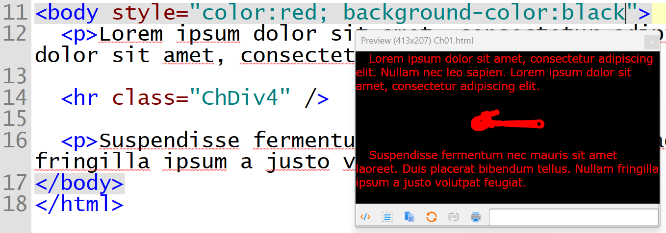

Also, this technique is not limited to svg...it works fine with .png and .jpg...just remember it is using a mask, so none of the image detail will be visible, just a silhouette. Here are some screenshots with a .png
-webkit-mask-image: url('../Images/img_ChDiv.png')
Name:	Screenshot 2024-12-05 122653.png
ID:	212359 Click image for larger version
Name:	Screenshot 2024-12-05 122637.png
