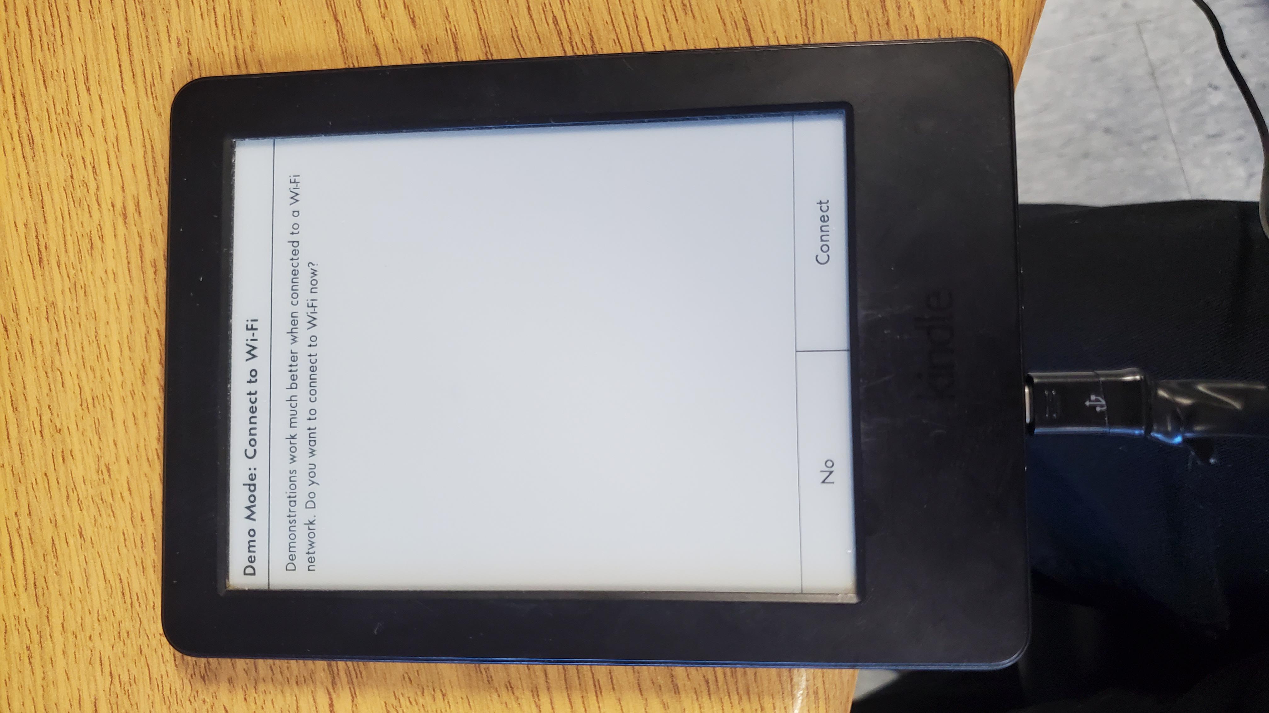

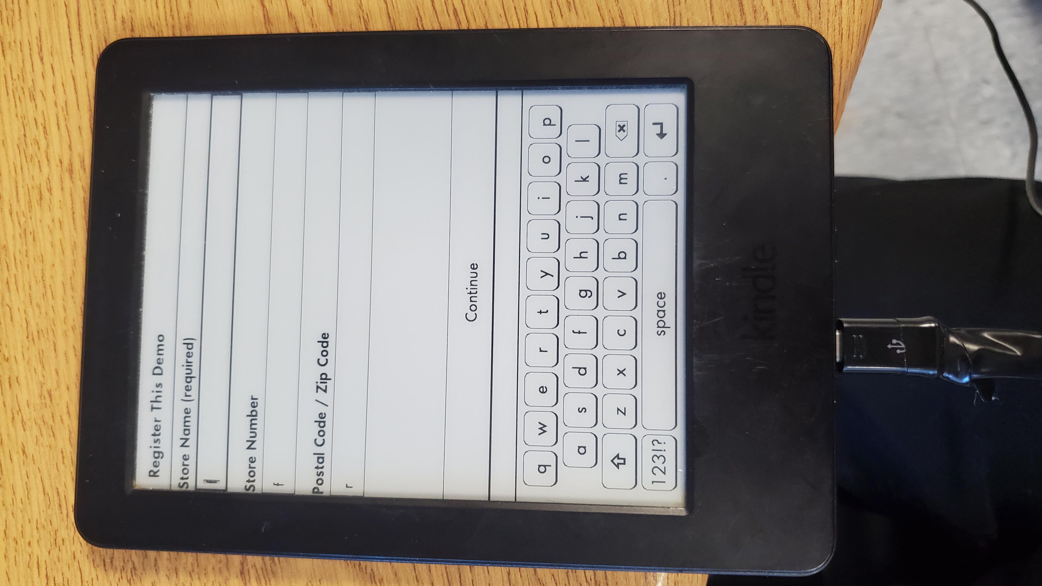

Stuck Configuring Demo
I recently started the jailbreaking process for my Kindle Basic (Model WP63GW), but am stuck entering demo mode. After skipping connecting to the internet and entering dummy store information, I am brought to a screen titled "Configuring Demo". The device remains on this screen until it powers off either on its own or when I tap the power button, at which point it returns to the demo wifi configuration screen. I have tried with and without connecting to wifi as well as holding the power button for a full minute, but am out of ideas besides attempting to reset it by connecting it to my PC. I haven't been able to find anyone with a similar issue online, but I apologize if this thread is redundant. Is anyone aware of a fix or bypass?

I have tried it, but it doesn't seem to work likely because I don't have access to the normal screen for it. I'm fairly confident that I'm doing it right since I've done it before on other devices, but I only have access to these three screens in the current state. http://drive.google.com/drive/folders/1VSZK-zUuJt0xPI5aAbyuweXcirEp-Q_0

Unfortunately I am unable to access the main menu or search bar since it never makes it past the configuring demo screen. Is there any way to get to the main menu from one of these screens: http://drive.google.com/drive/folder...yuweXcirEp-Q_0 ?
Sorry about that!
