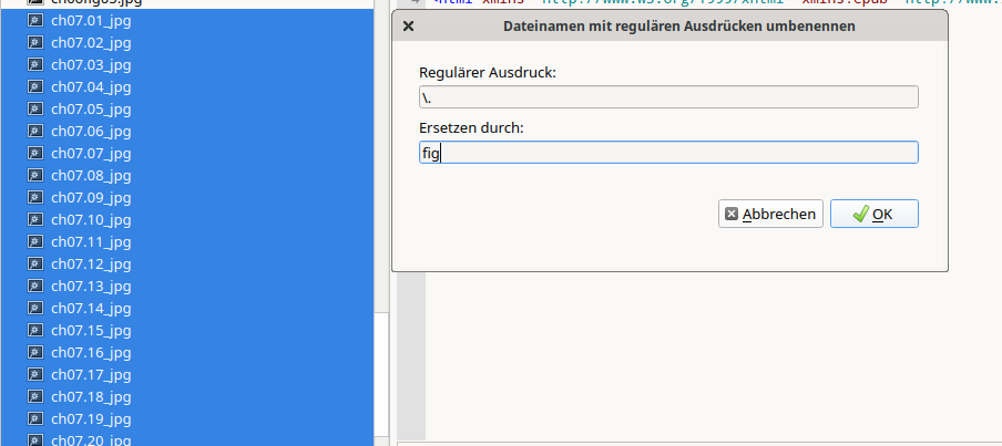

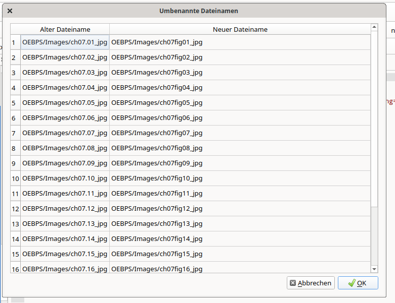

Anyway, I wanted to do a mass regex rename of some image files
As you can see the results aren't as expected. The preview shows the correct result but when I actually click ok it turns out completely different.
Is this an error in Sigil or am I doing something wrong?

If I remember correctly, you are matching any . in the original filename and replacing it with fig. This would include the . between the chapter number and the image number as well as the . prior to jpg.
A search string something like ch(.*?)\.(.*?) and a replacement string of ch\1fig\2 is likely to be closer to what you need.

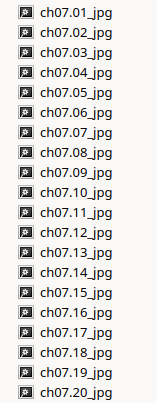

Hi David,
The problem is, there ISN'T a . before jpg. It's just _jpg

It seems none of the original files had a valid file extension?
The RenameResourceList code in OPFModel, extracts the file extension from the original file name, runs the rename, then adds in the extensions.
See https://github.com/Sigil-Ebook/Sigil...Model.cpp#L346
But since no actual file extension existed, it extracted the .01_jpg, .02_jpg, etc as file extensions.
So to handle this case properly, you should use normal rename to add the proper .jpg file extension first to all files, then use the RegexRenamer with the find text properly modified.
Or take the results of the REXRenamer and then run it through a normal rename of file extendions last. Either should work.
