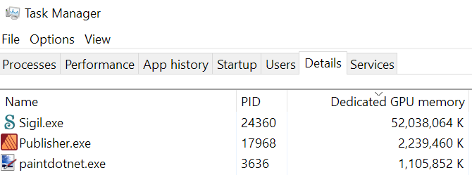

Hello.
I must admit, I wouldn't have expected that my RTX4090 would ram out running, Sigil, but it seems to be the case with v2.31
Is this memory leak documented, with a fix on the way?
Sometimes, I've come back home to find Sigil consuming >20GB of VRAM. Quite concerning!

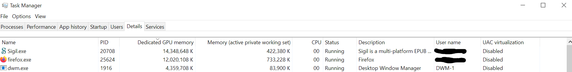

Ok, now we are up to 24 GB of VRAM used, only since this morning!
I've just disabled GPU Acceleration, but I switched it straight back on again. Taking it off made Sigil run like garbage, clunky like you wouldn't believe

OK, I just did some experimenting.
I was able to get Sigil to go from about ~200MB of Memory use, up to >50 GB of memory use, in about 30 seconds.
All I had to do was grab the boundary for the "Preview Window" and resize it about 20 times, through click-and-drag.
Obviously, this would have maxed out my 4090, and then spilled over into my RAM to get this high.
Whose responsibility is this? Can we make a bug report and have it patched by the same people who fixed the Mac version, as already indicated?
