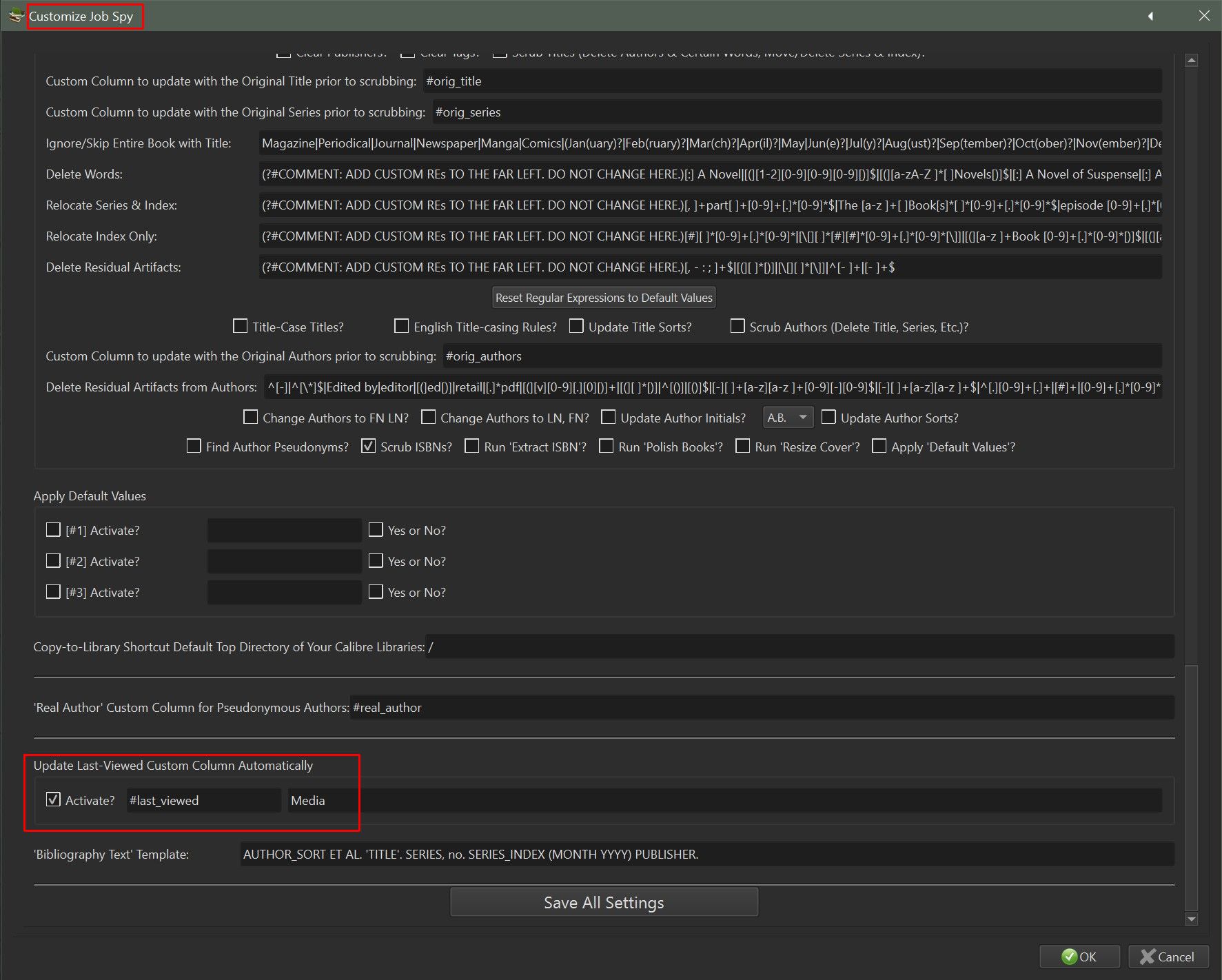

There's a Customise option in the JobSpy plugin:
Name:	Screenshot 2024-08-06 083431.jpg
Works with View and calibre's Open with.
Thank you BetterRed,
Here's a brief description of what I did to get this working in case anyone is as clueless as me.
1 - Install the JobSpy Plugin from within Preferences > Advanced > Plugins
2 - Set the flag 'Activate' within the JobSpy plugin
2 - Create a custom colum from Preferences > Interface > Add your own columns
Here are two screen shots showing required information.
All the best
