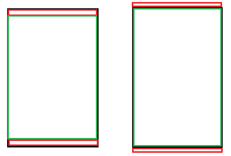

Sooo, here's a pic to demonstrate what I was trying to explain. This is my current theory. I'm open to others...
Name:	Screenshot 2024-07-30 163458.png
The black square is the physical display...assume an 800x600 dimension.
The red squares are the header and footer...assume a 50x600 dimension.
The green box is the device/app calculated display size for the html page.
The left image shows where the device/app determines the header/footer positioning first, then the remaining landscape (700x600) is used for display of the html page. In this case the use of 100% or 100vh would return the 700x600.
The right image shows where the device/app determines the display size for the html page first (800x600) then adds the dimensions for the header/footer for a total (900x600) which is greater than the actual screen dimension.
The problem here is that you don't necessarily have to display anything in the header/footer, it's enough that the device/app reserves the space ... thus causing an overflow situation and an extra page.
Depending on what methodology the device/app uses to calculate display/page size, you can have some show the extra page, and some not.
Attachment 209840
ADE/RMSDK does not show blank pages that I know of. Bookfusion does show blank pages.
Unfortunately I am not privy to which methodology the different devices/apps use....so the only way to get it fixed is to submit a bug report to the respective programmers.... Obviously after you've checked that there are no problems with the epub code itself.
FYI, I got this theory from conversations with Kris during his creation of Marvin. He did not publish a fix, so Marvin also suffers from this minor, but annoying, problem.
