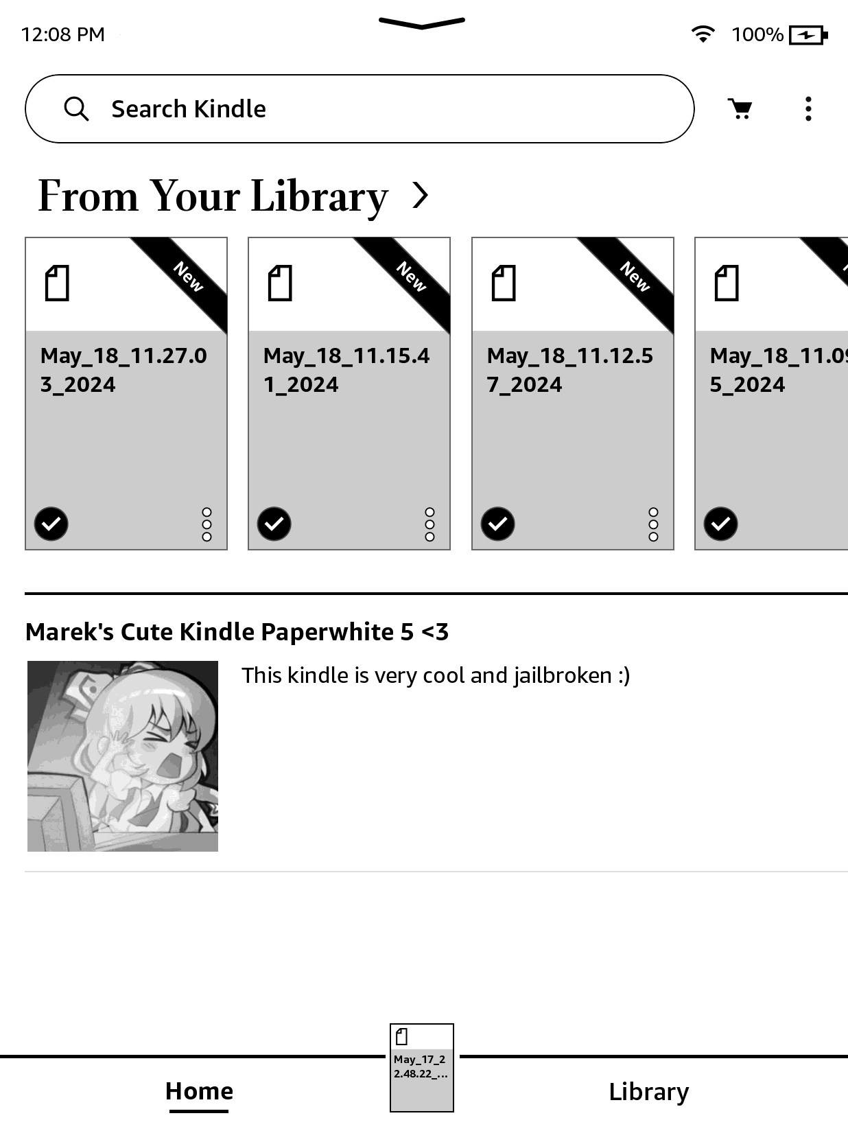

You can modify the homepage when I have a bit of time i will write my findings and some basic patches for anyone to apply

Marek, you might want to change that image to an attachment or shrink it to a maximum of 600x800.
I am surprised the forum allows people to post full res images like this. It should downgrade it to 600x800 by default. Full res images should only be allowed as attachments.

It would be fantastic! I wonder if homepage layout could be tweaked to include remote webcontent either static or dynamic (weather info etc.)
You'd need to figure out how the API works and where to change the url but most of the content is pulled from there (i can't remember the name sorry) in the image above i changed the local copy of the data (it refreshes periodically)

What I was referring to was using the Manage Attachments or paperclip tool. While the image URL is wrapped in URL tags, that does not seem to work. Using IMG tags works but still leaves the image at it's full size.
